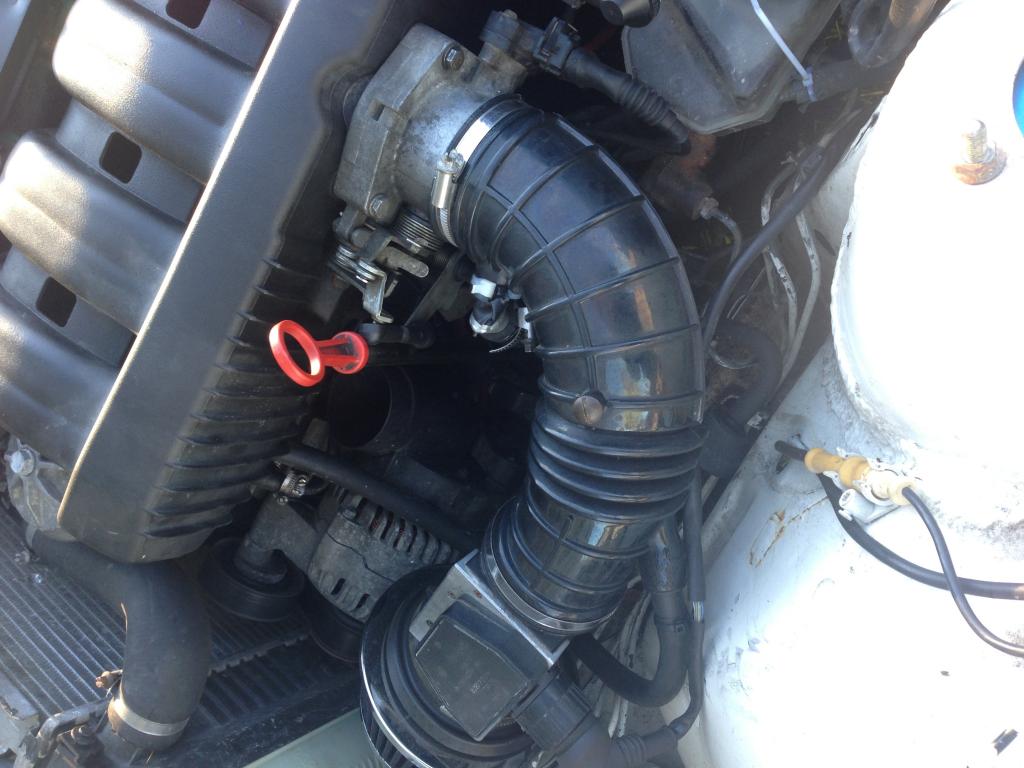

              Just took a look, and remembered there is some vacuum line that is missing from the equation. The spot on the middle of the intake on top is just plugged with a bolt. I'm not really sure what is supposed to be here and where it goes?

                on top? Do you have a picture? There are two vacuum ports on the intake. One is a small port on the bottom near the firewall which should be connected to the FPR on the fuel rail (right up against the firewall on top of the engine) and the other is a large port on the side of the intake facing the driver's side fender. This large port is connected to the power brake booster, assuming you have power brakes. If the FPR is not connected, the car will run rich and fuel economy will suffer.

                  I took this attached picture this morning. You can see the bolt plugging it.
                  • nando
                    • 34839
                    I don't know about that boot but your hot air intake isn't helping things. :(

                      On the intake boot? That's not a vacuum line. One line runs under the intake for the ICV and the other line runs to the valve cover. It looks like you have both of those so I don't know what's up with the screw/bolt. However, your ICV line appears to be patched with tape? Replace the line because it will leak metered (post-MAF) air and make the engine run like crap.

                        the air from alternator messing up with MAF reading. You need to have a proper intake setup,
                        • nando
                          • 34839
                          That will make it run leaner, not richer.
