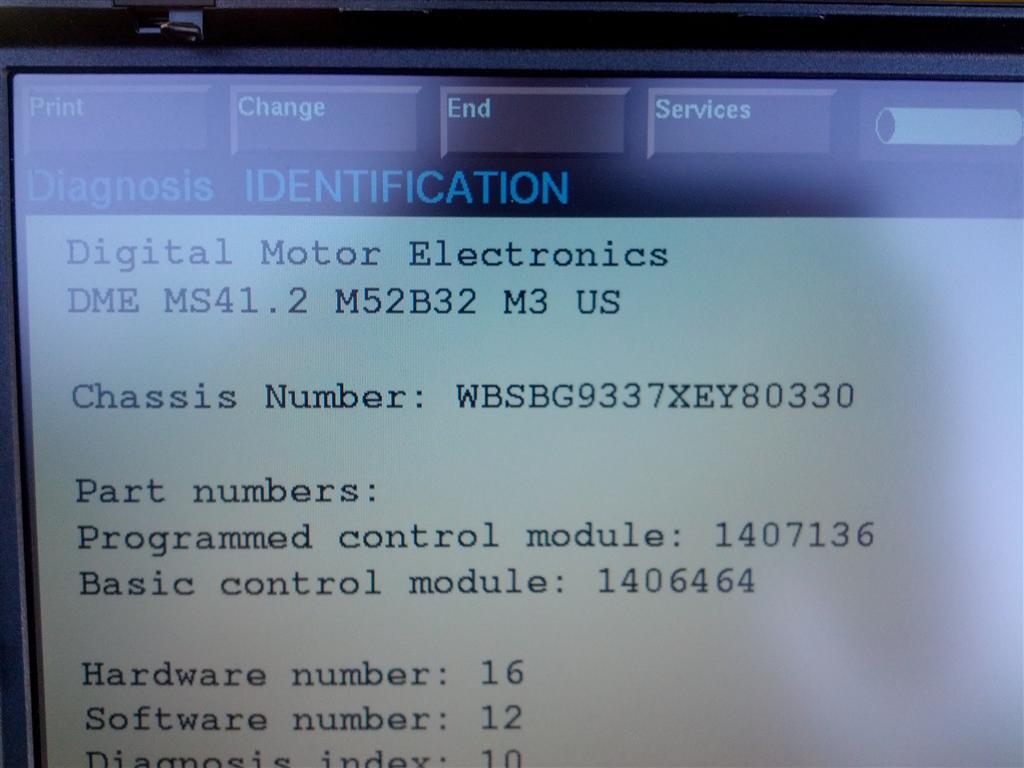

          I like how even BMW calls the US "///M" engins just M50B30/M52B32.
