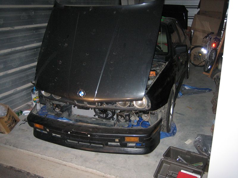

    You can see on my car I have two 10" fans mounted on the front, probably overkill, but hey, thats what I like :)
    Sorry for the crappy pic, apparently I never took pics of the fans installed.
