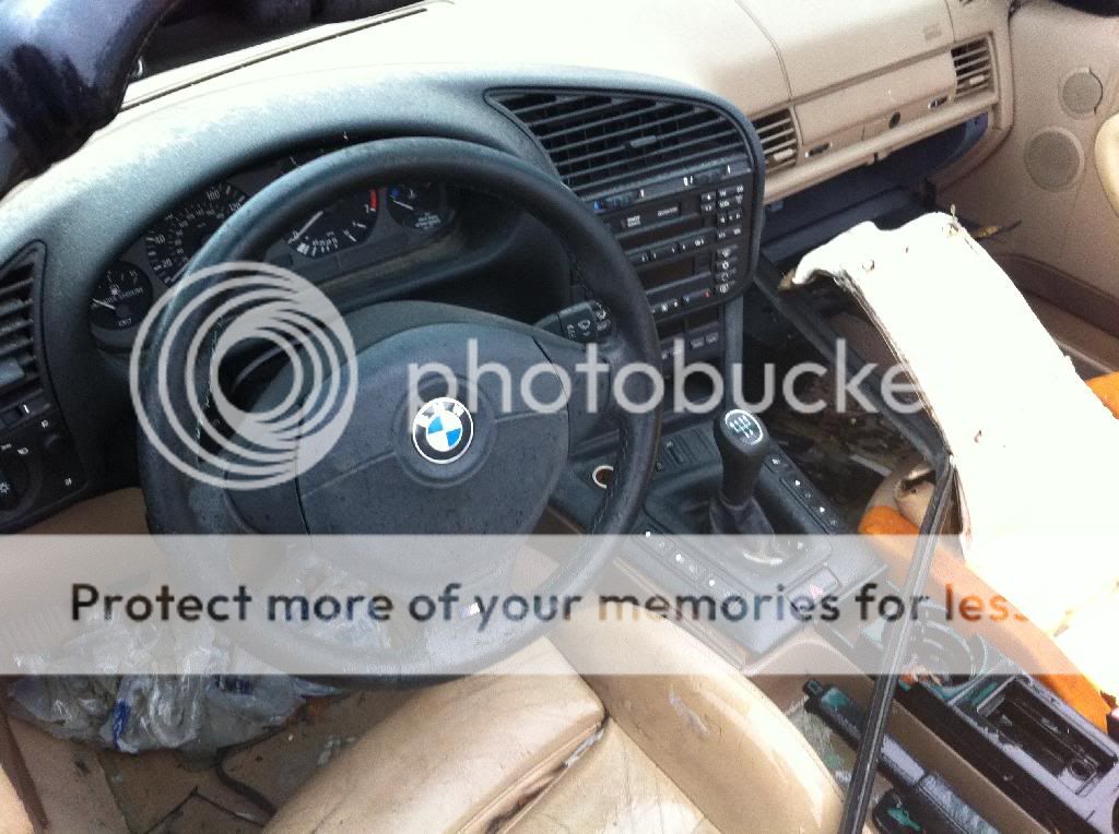

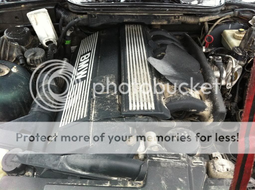

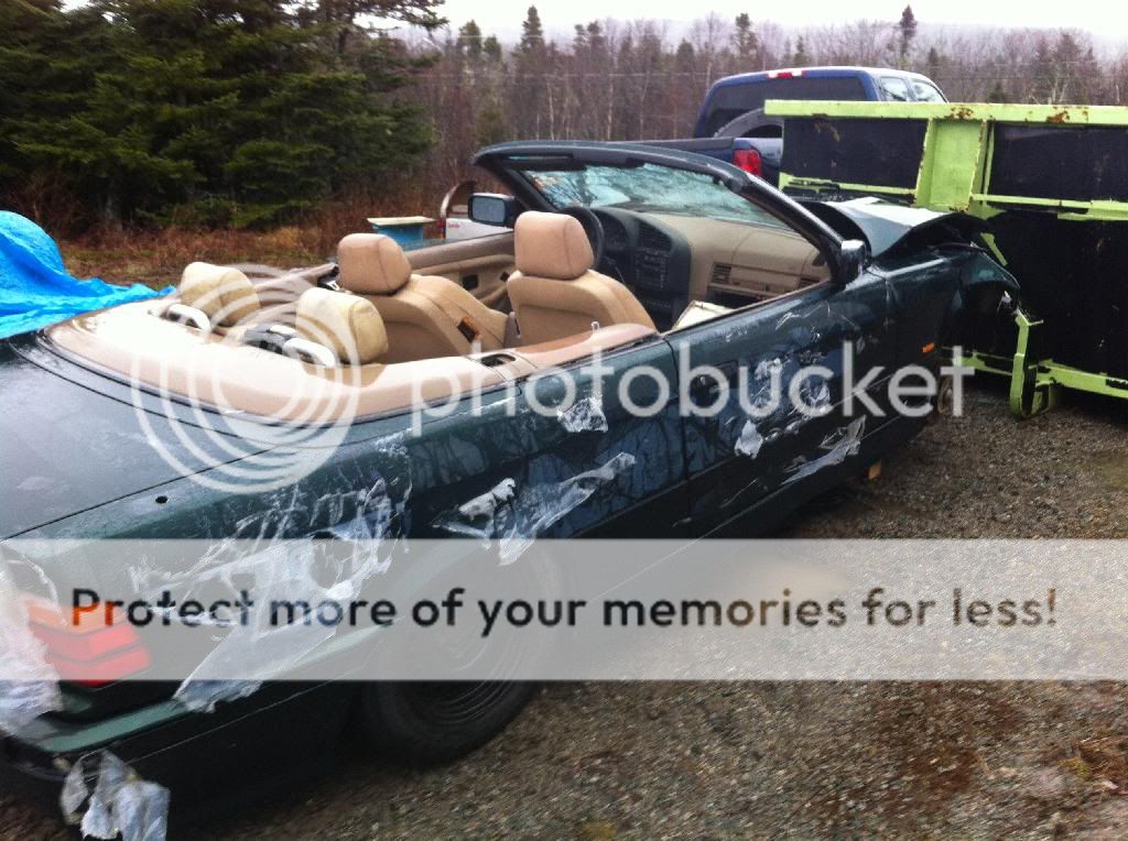

                              off topic but here is my baby lol
