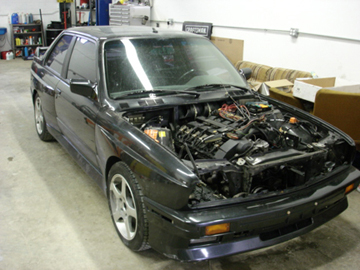

    I picked up a 90m3 to swap in lieu of fixing the 89is. (yes, i did get hammered from insurance after the deer incident.)
    I have heard rumor that the s14 tach gets a different type of signal from the dme and that swapping the coding plug is not a viable solution.
    Anyone have experience with this?
    Thanks, Jason

            nope, engine is installed, bu not driving yet. i just want to have everything figured out before i dive into it.
            i sure have put a lot of time into it. engine fully rebuilt and assembled.....done. transmission resealed, lightweight flywheel, diff and shortshifter.....done. ie springs, big sways w/ block reinforcings and stainless lines....done. adjust rear subframe and poly's.....done. aa stainless exhaust and track pipe.....done.
            ive got all the wiring figured out, but i do not have the s14 c101 plug to fit the chassis plug. im using the m20b25 c101 plug but moving the pins.
            now im in your boat. i just need to find an expansion tank with a level sensor.
            cheers, jason

                      car looks good in the pics. I didn't need a level sensor so I just got an expansion tank and made a custom mount for it. I had to use a lot of hose to plumb over to it the way I wanted but it turned out really nicely. I'll send you some pics tonight. I have a friend that swapped an S52 into e30 m3 years ago, I'll ask him if he remember what he did.
                      My cars going to the exhaust shop next week, I've driven it, but it's too loud to make a habit of :)
