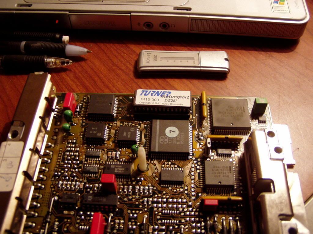

              • Nick_S
                • Apr 2011
                • 3658
                Originally posted by ascendotuum
                I thought about opening it up but I don't even know what to look for once I'm in there.
                Turner Motorsports chip vs stock chip
                It's pretty obvious.
