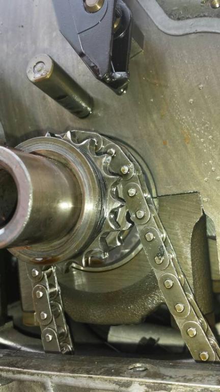

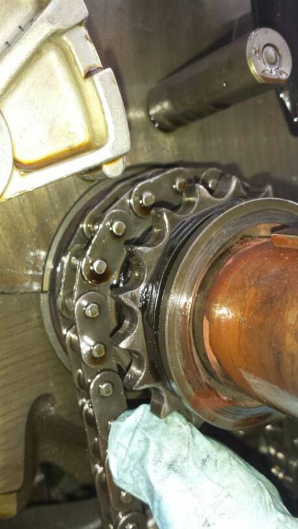

ID:	7164959Click image for larger version

                              Tapatalk is weird. sorry about the double post.
                              Should I be concerned about the sprocket? The chains will be replaced. I think there is some abnormal wear from the oil pump sprocket coming loose.
