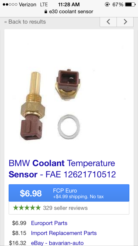

    anyone have a p/n for the brown coolant temp sensor? Thanks!

          • iwantspeed
            • 3164
            I'm pretty sure this is the part number you need for the brown single pin coolant temp.
