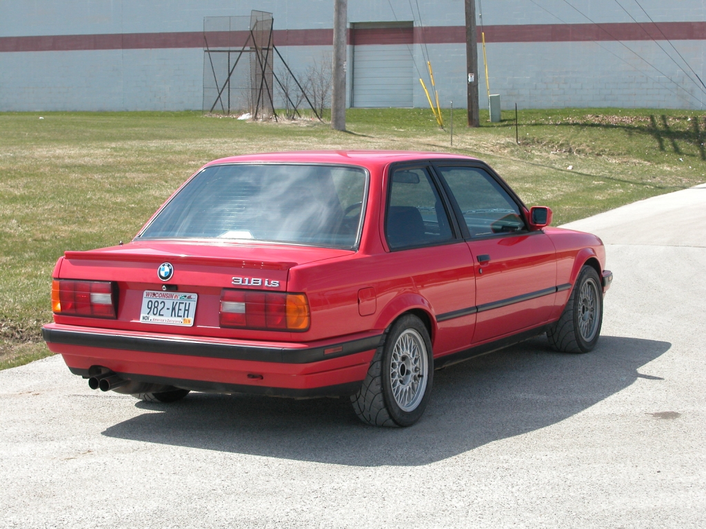

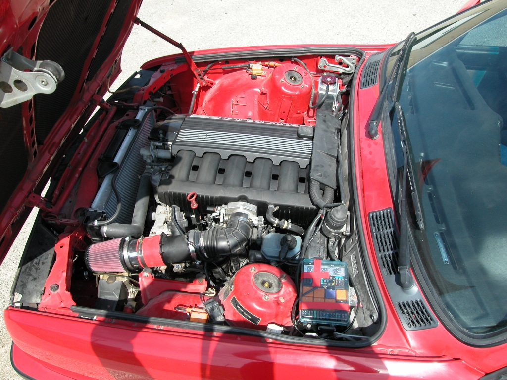

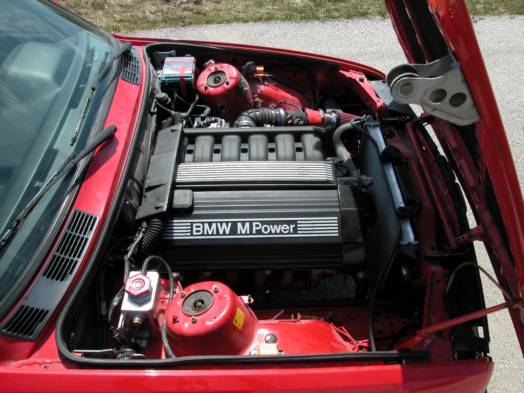

              ok, here come the pics, I didn't realize r3v had a gallery, what do i know??
              and yes, I know it needs an IS lip spoiler in front, but I have some other issues to work out before I spend on the body:
              say what you will

                Originally posted by Beej '86 325es
                That's awesome man! Congrats on getting it all together! What type of bolt ons did you do?
                Pics!
                bolt on: bimmerworld ltw flywheel, m5 clutch, UUC ltw pullies, 3.5" HFM, 24lb injectors, conforti chip for all the stuff, not so cold cold air intake, 3.46 diff, e36 m3 trans.
                The gearing is aggressive, but I like it. it revs up nice and fast I was pleasantly surprised. The throttle response is really good too, at least compared to my mom's e39 528i sport (5-speed). that thing has the worst throttle response of any car there is, period.

                    Originally posted by Ryan Stewart
                    Winter tires, eh?
                    Welcome to the club.
                    whatchu talk about willis? Those are Falken azenis sports, basically slicks for the street...mad traction
                        sarcasm, man, sarcasm.

                          • SchnellerVert
                            • Sep 2005
                            • 3948
                            What are you using for you catch tank? That's an interesting setup?
