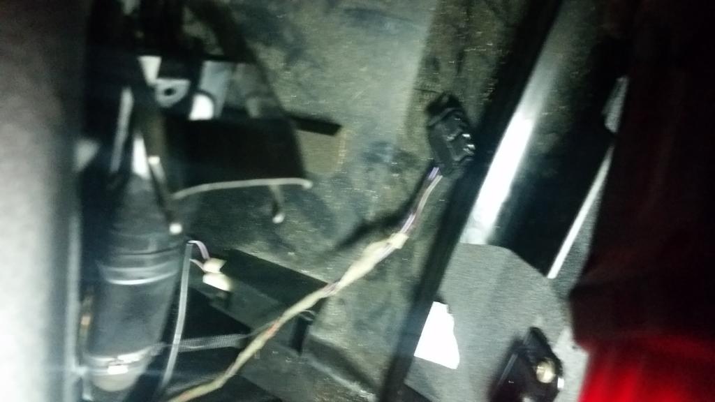

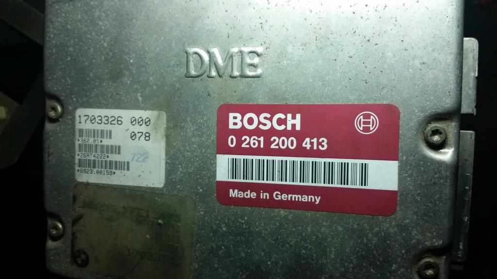

              Took a look at the DME. Snapped some pics for reference. Seems like the red label 413.

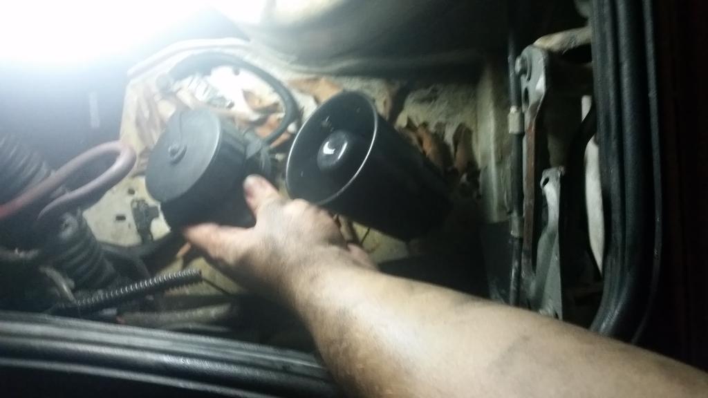

              Check out the alarms in the bay. Looks like there are 2?
              Also there is a plug not connected in the glove box.

                  Ok so I jumped the Fuel pump terminal. Let me know if i messed up. I took a small gauge wire and stuck it into 30 and 87. I didnt have a helper so I took the lines off and placed a towel. NOTHING! Bone dry. I also tried it with the lines connected nada. Ok maybe the ecu is fried (Red 413). Now I did the same thing with the 85 and 86 with my Multimeter got 11.7-11.9V. Again fusible link is like new condition. Do I have to go wire hunting?

                          I would say there is 95% chance it hasnt. At least not by my buddy who sold it to me. I just pulled it out and it was very hard to get out the harness. Now I just need a known working unit. ( i have a 413 red label) anything out there better?
