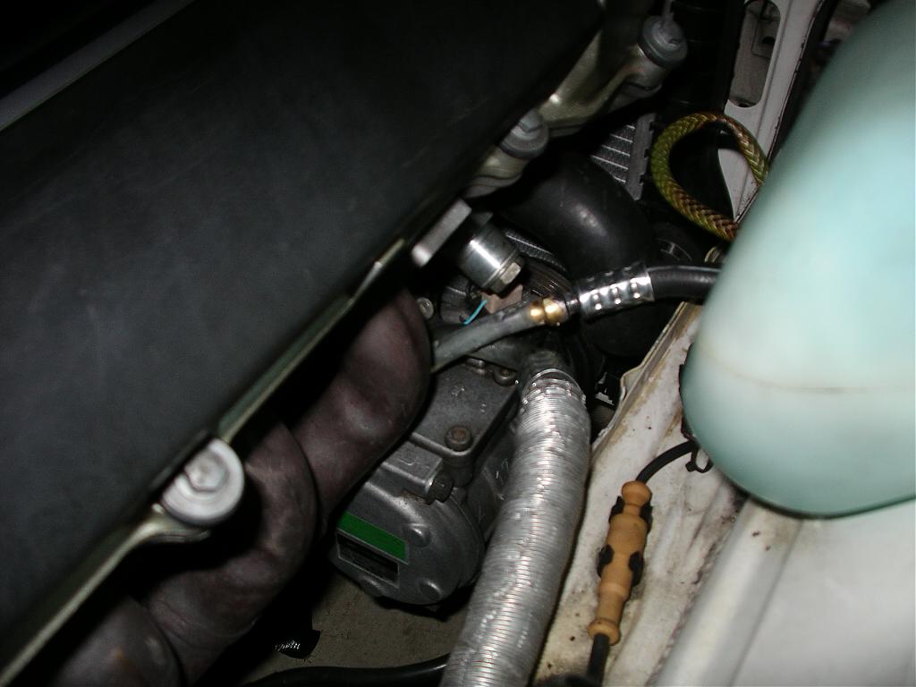

    Hi John,
    Sorry for the delay :oops:
    This is the best I can do. It's not an easy place to take photo's.
    These sort of show the adaptors on the compressor. They are basically the ends cut off the E36 hoses (with a bit of the metal pipe left) with a standard A/C fitting silver soldered on the end. You bolt the adapters to the compressor, and can then screw a regular threaded A/C fitting to it. You can't really see it in the pictures, but there's a male thread coming off the adapter which the female nut of a standard fitting screws onto.
    This is the other end of the flexi hose. Instead of having the hose crimped directly to the end of the metal line from the firewall, I cut the original and had another male fitting silver soldered on the end (and re-plated afterwards).
    Cheers,
    Ian.

        Thanks Ian,
        A very nice solution, and one I'll definetly do next time.
