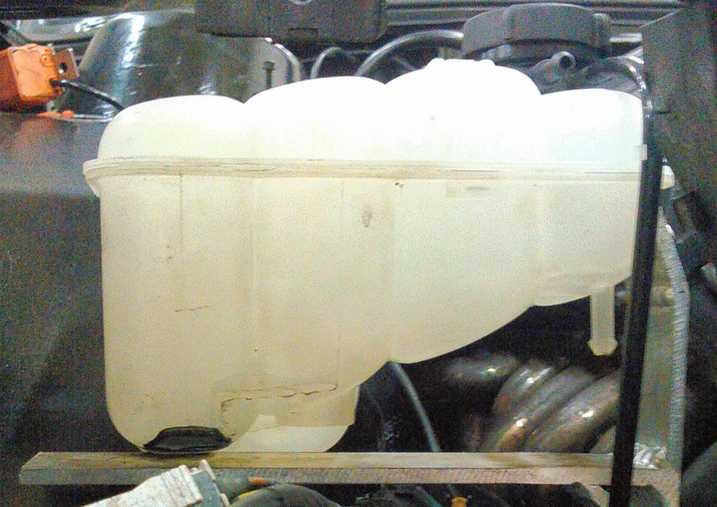

              Still waiting on the ecu but can anyone tell me the routing of the small ports on the late m20 expansion tank? Where goes to where ( one near cap and one underneath). Also. Does the coolant tank need to be level or above the radiator? Or does it not matter because it's pressurized?

                Figured out all except the port on the bottom of the tank...... Also I have no sensor on the top..... Fear I may have the wrong tank....? Any ideas ?

                  • sweet3
                    • Oct 2012
                    • 752
                    That bottle doesn't look 100% correct, but it might still work.
                    The bottom hole in the reservoir (if its on the driver's side) should go to the "spider hose" which runs from the "thermostat area" to the "heater area".
                    The port by the reservoir cap should go to the hole on radiator at the very top (If you're using the stock m20 radiator)
