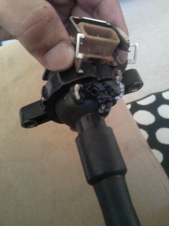

    Driving to my buddies and I noticed the car stumbling. When I apply more throttle it was obvious that its a misfire of some sort. I pulled over and saw some smoke coming out from under the hood. I pop the hood and poked under and there was a clear smell of burnt plastic. Figured it was a misfire and found this...
    Fast forward and the #2.coil is replaced but I'm still getting the same misfire.
    We pulled the other coils and none puked out the plastic like this one did and the car definitely stumbles worse when we pull the wiring. I still think theres a hairline crack on another one thats not obvious like this one was, but Im still hoping you guys have an idea of what I am missing
    Any thoughts?
