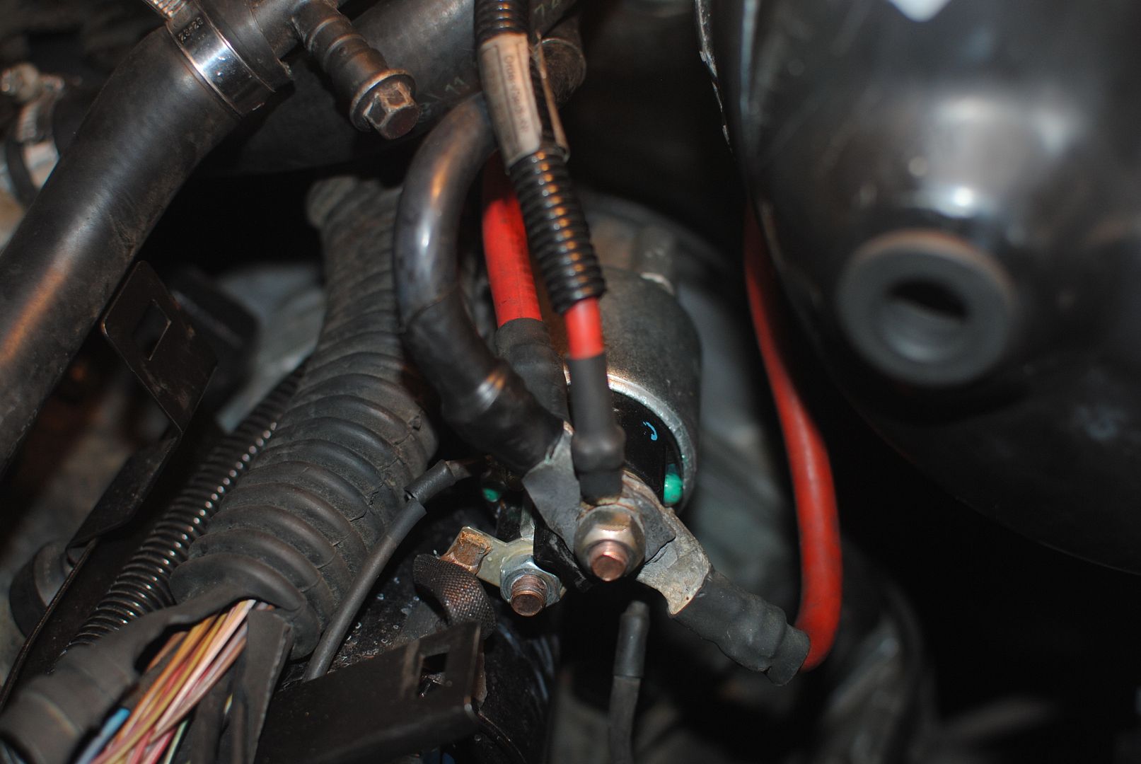

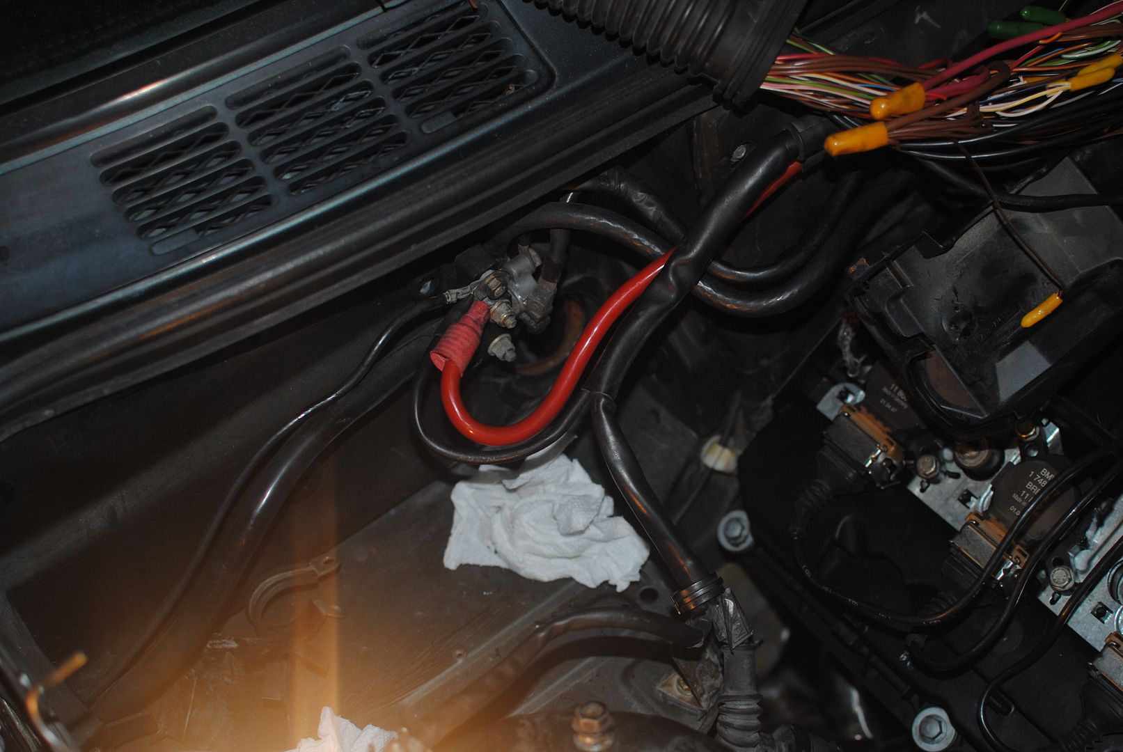

    the large black starter wire running from the distribution lock to the starter that was originally used for m20 , do you keep that and run it to the starter ,
    or can you get rid of it since there is a red large wire running through the harness that goes to the starter , on the starter side there is a large red wire and small red wire that i believe goes to the e36 fuse box??
    any input
    OKAY SO I GOT THE CAR TO CRANK, now i have no fuel and no spark ? any idea
    i jumped the fuel pump so i know it works
    need some input
