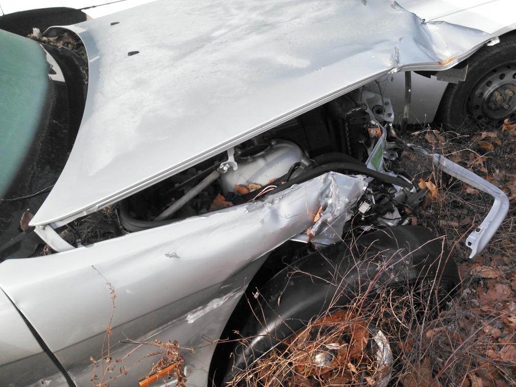

    I would like a new motor in my 87 325is. What are the chances that this motor is OK for a swap. I do not know what year the car is. I took a pic of the vin. What should I look for to see if the motor is trashed? How much would this motor be worth? The car has an automatic transmission. Could I use the 5spd that is currently in my car or is it too weak?
    The VIN number is WBSCD0325VEE12418
    Thanks.
    From this info it is hard to tell. It looks like it has setup a while. Your best bet is to check for signs of anything wrong. Check the oil and coolant for mixing. If possible take a jump box and do a compression test. I did just that in the junkyard when i chose my motor. The good thing is that its got an automatic transmission which means there is a much better chance it was never overrevved. As far as will it work with your transmission that is a yes. People have differing opinions on trans setups so youll need to do lots of research first.
      The car was wrecked in 2012. What are the chances that the engine mounts have been hit so hard that the block is damaged. I never really thought about that over-reving issue with the manual trans. So, I can see where the auto could be a good thing. But, I really wanted to swap in a more modern 6spd.

        I have sen the mounting arms break, never a block. Do a compression test and check fluids like said above. Try to start it if everything looks there. It will clean up just like any other 24v.
          Can you tell if this is an s50 or s52? I inlcuded the vin, but did not look the car over for any other signs of the model year. I should have just looked at the door sticker for a build date.
            realoem.com says its a 1997 M3 s52 build date 6/97. Try to light up the cluster to check the mileage on it. Or carfax the last known mileage.
              Thanks for that info. I am not sure if there are keys to this, so I will have to figure out how to bypass the ignition. If the compression is good and the mileage is in the 100k zone, what could I expect to pay for this engine?
                Its been sitting there a couple years so no hurry on it. Get it as cheap as you can. I'd offer $400 on it with all the electronics but not pay over $1000 though. But thats me. The good thing about wrecked cars is they were running at the time. Carfax it for the mileage. I dont know how to get past the EWS without having a key.
