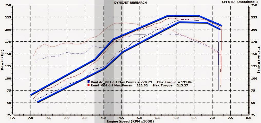

          • tonerrrr
            • Jul 2011
            • 935
            This one seems more like it for sure, I added some lines to better see what what happening on the graph. The thing my video doesn't show is how it puts you back in your seat once it's around the 4k mark. I'd say this graph is close so maybe it's just normal?
            instagram: @tonerrrr
            High resolution E30 Fuse Box 300dpi PNG
            • 328ijunkie
              • May 2007
              • 3961
              You highlighted the two HP curves lol. The torque curve is the 'put you in your seat' feeling. You also may be feeling a strong pull at ~4500 or so because of a flatline/dip before that where the power flat lines similar to the blue graph here:
              Which then suddenly wakes back up after flatlining giving you a feeling of pulling hard.
              You also may just have a wonky AFR issue down low that gets sorted once the engine gets up to speed

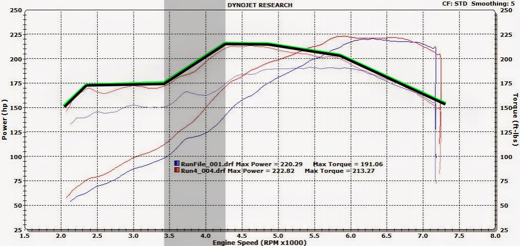

              • tonerrrr
                • Jul 2011
                • 935
                Thank you for the insight, I know I highlighted the HP but that's what it looks like it feels if that makes sense lolol
                This one looks like it kicks in early... I guess the thing to do is put it on the dyno and see how it looks as well as wait to hear back from Jesse.
                Here's where I highlighted the torque but mine comes on a little later. The spike is there though.

                • tonerrrr
                  • Jul 2011
                  • 935
                  Did my vanos, rattle + seals, 100% fixed and a world of difference. The new cams must have accentuated the vanos problem as the vanos seemed fine beforehand, points to ncbrock for being correct!
