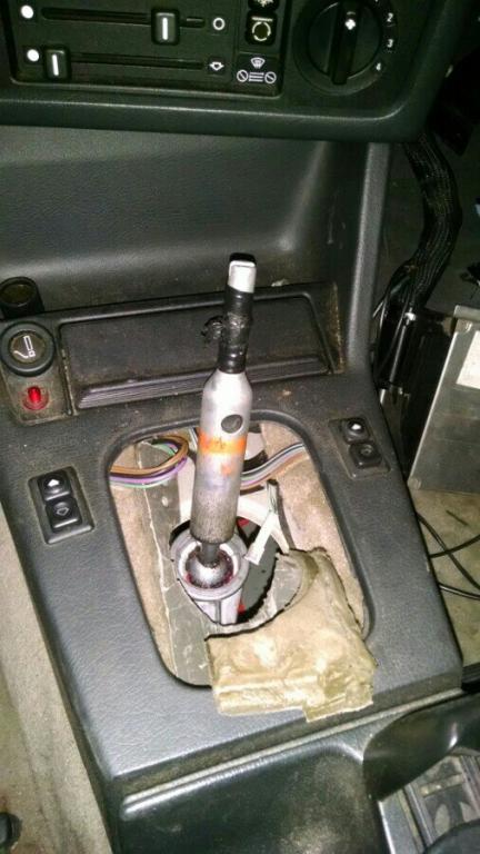

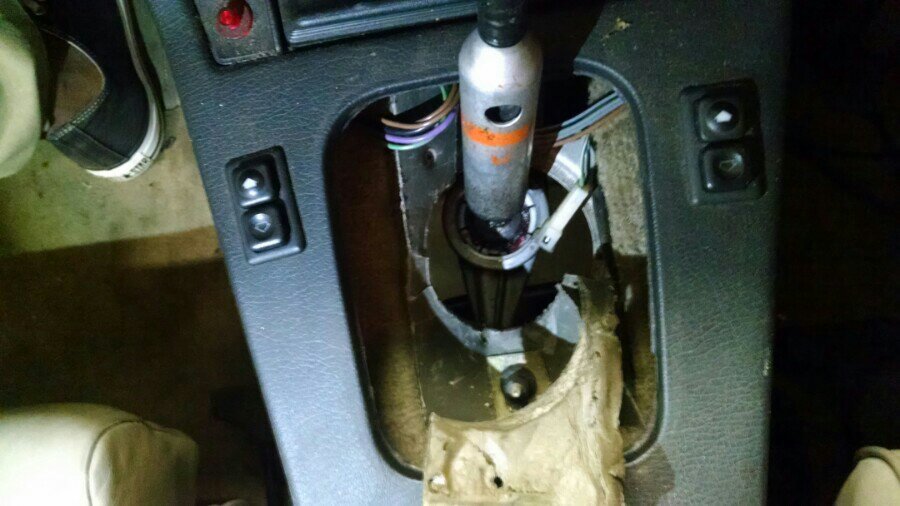

    Hey r3v, I'm currently swapping an m52 with zf320 into my 85 325e. everything is buttoned up and working except for the shifter... It sits too far forward in the little hole. After some extensive WTF moments, I've figured out that my entire drivetrain is 2" too far forward. Does anybody have any ideas on how to correct this? I'm trying to take this car to SoWo in 6 days HELP ME!

        Post some photos lets see
          Sent from my XT1060 using Tapatalk

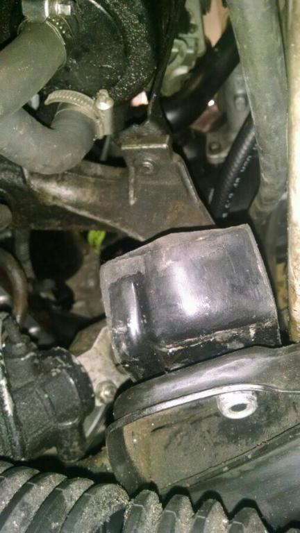

            not that, the motor mounts
            • gotane30
              • Apr 2013
              • 332
              I'll get some in a bit when I leave work

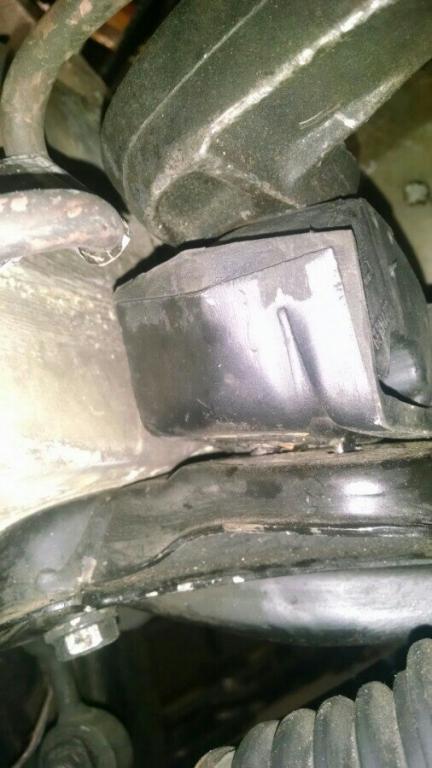

              • gotane30
                • Apr 2013
                • 332
                Passenger side is on the bottom
                • DesertBMW
                  • Aug 2011
                  • 1040
                  Engine looks like it is properly mounted, all though you need to install 4mm spacers on the mounts for proper leveling.
                  • gotane30
                    • Apr 2013
                    • 332
                    Thanks. any idea why I may be short then? I've got the same carrier and everything from my 91, and that didn't have any spacers. This is driving me nuts.

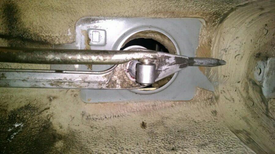

                      I recently got the shift linkage installed into my s52/zf320 swap on my car. Using revshift motor mounts. I did notice that both the e30 and e36 shift carriers (aluminum arm that attaches to trans) didn't quite fit right. Now that's not necessarily the fault of the motor mounts - they sit the engine fairly close to the firewall. I'm guessing the issue is just how the back of the ZF is - slightly different design or length than the original Getrag. The e30 linkage seemed too "short" to fit in the rubber mount at back of the trans tunnel. The e36 linkage seemed to put the shifter over to the side too much. I wound up buying an e46 shift carrier and shortening it to match the length that's needed. It also does a better job of centering the shifter in the hole. I've got pics in another thread from not too long ago - do a search & you should be able to find it.

                          Here was my solution to the same problem. The carriers twist well in a vise but as soon as I tried to bend, it snapped. This was alright as I needed to extend it anyways so I made this little angle bar and used loctite and locknuts.
