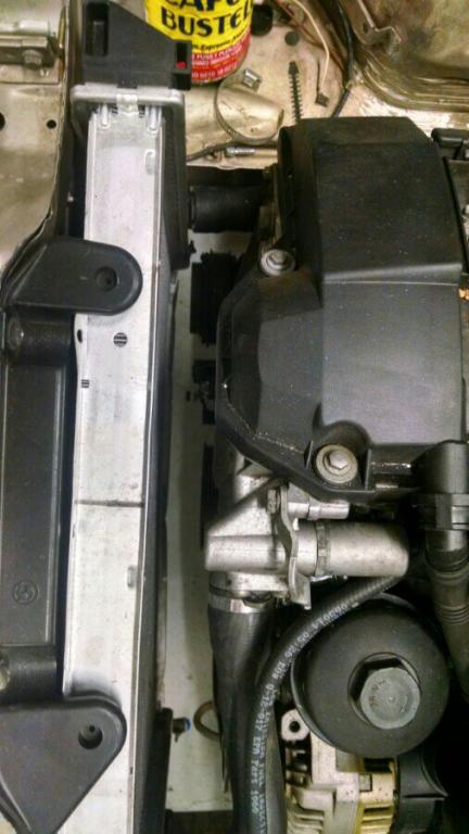

    Originally posted by M3PO
    Post a pic of how the motor looks in the engine bay. If you engine really is 2" forward, the accessories must be super close to the radiator.
    I'll get a picture in about an hour. it may not be exactly 2" you understand. I'm estimating.
    • gotane30
      • Apr 2013
      • 332
      Sent from my XT1060 using Tapatalk
          I just measured mine and the closest point of my S50 valve cover is 1.75" from the closest point on the radiator.
          I have the AKG engine mounts, ZF trans, E36 M3 shifter assembly, and IE trans mounts and my shifter is in the middle, front-to-back, but off to the right a little bit.
