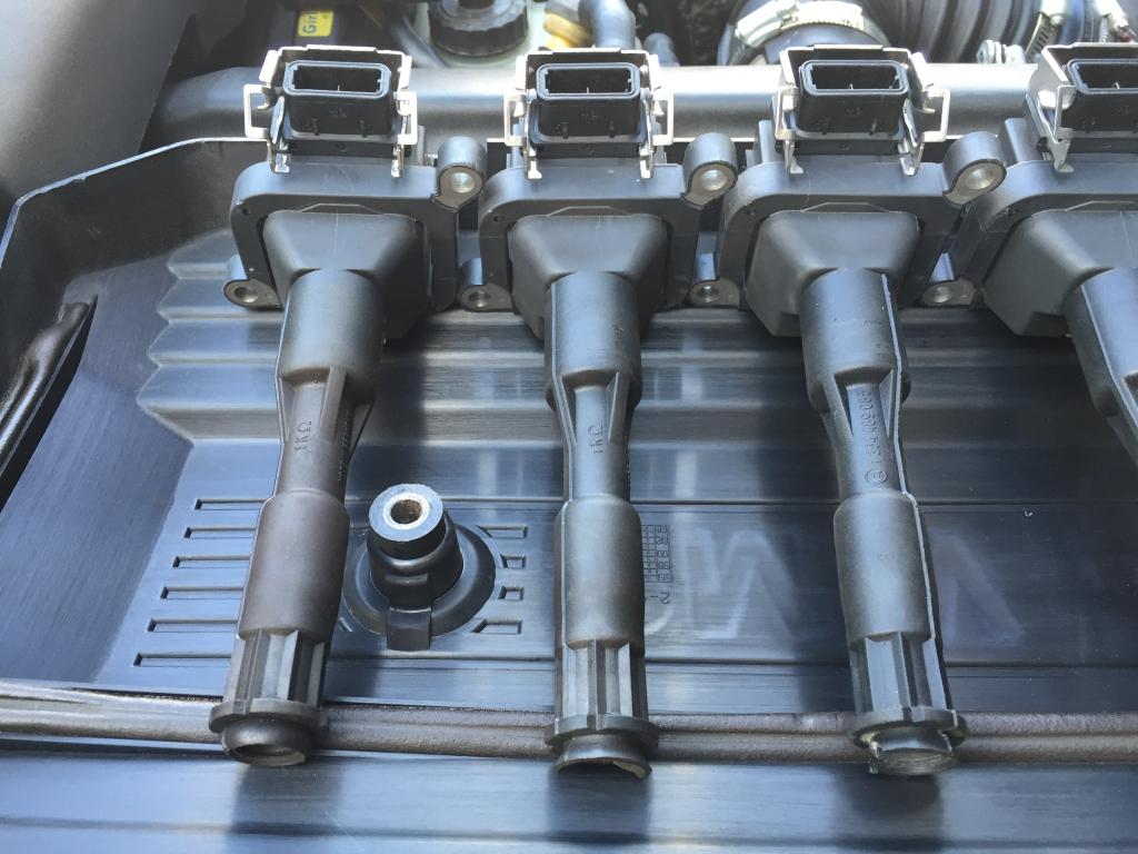

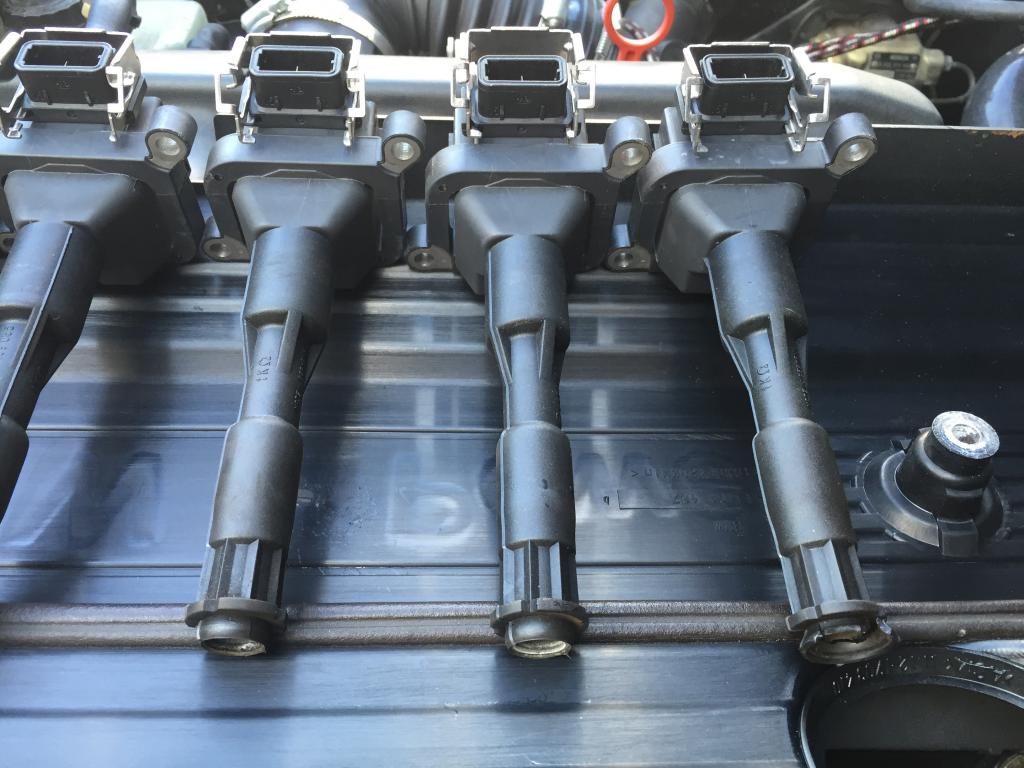

              Got CELs 1271, 1274. And 1215. Ign Coil #1, Ign. Coil #4, and MAF. Used some MAF cleaner and that didn't keep the code away. Switched coils 1/2 and 4/5 hoping to see the code move to those cylinders. strangely they did not. I came across a thread about hairline cracks in the underside of the packs causing this behavior. Examination of all 6 showed what I would consider the start of a crack on almost all of them. So they are all bad or none of them are bad...

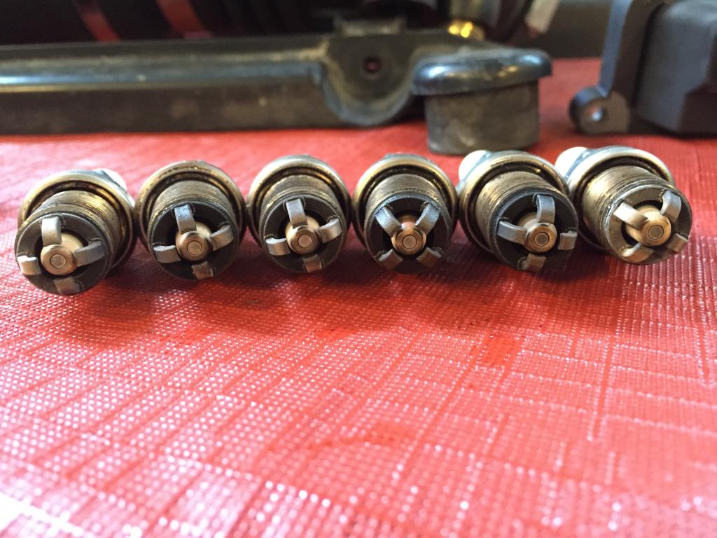

                        We're your old plugs black / covered in soot?
                          Plugs were not black. See attachment. 6, 5, 4, 3, 2, 1.

                            Also, here are the coil packs. 3, 2, 1.

                            • hammslice
                              • 120
                              And 6, 5 , 4.
