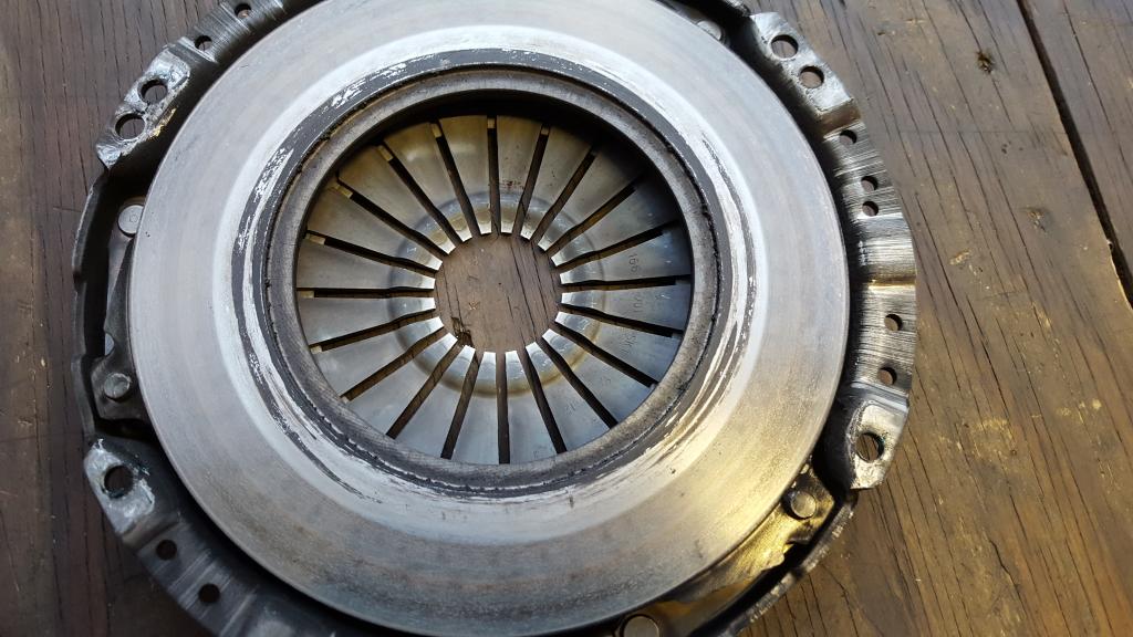

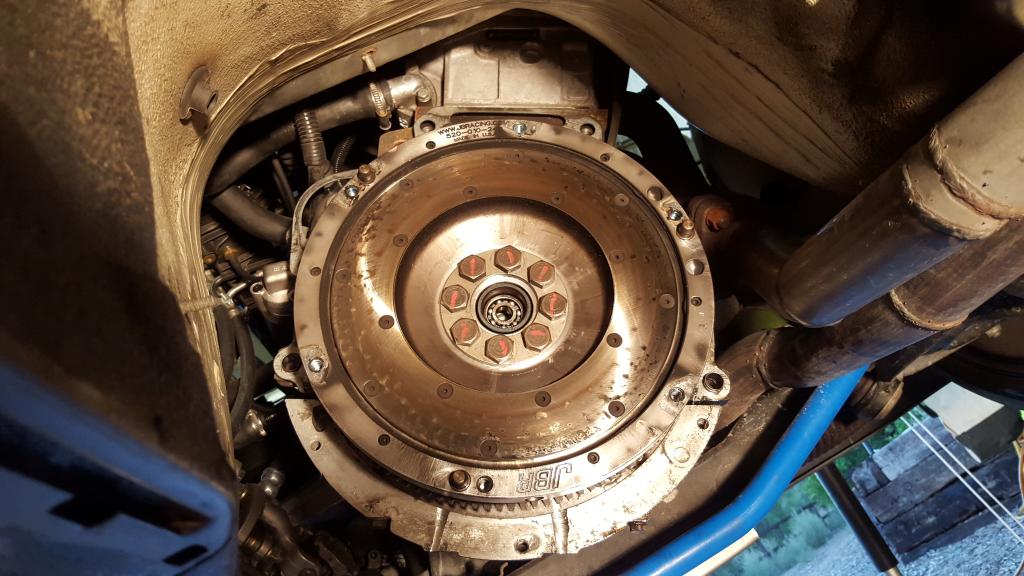

    So, this clutch and flywheel was brand new as of ~6-7,000 miles ago (flywheel was resurfaced). They when in the e30 along with the s52. I noticed a light bit of oil drip under the bellhousing, but also had some small oil pan gasket leak. I assumed both were the same, so I didn't sweat it and eventually changed the oil pan gasket with the intention of "keeping an eye on it". The original g260 trans finally kicked the bucket this past week so today I was swapping to a zf320. When I pulled the g260, the inside of the bellhousing was SOAKING wet with ATF. After I pulled the PP and clutch to change the pilot bearing, I was greeted with this sight. Looks like ATF got into the mix. You can see that inside ring on the PP is black probably a mix of clutch and ATF.
    I am assuming the clutch disk is garbage at this point. Is it okay to just wipe/clean off the flywheel and the PP and stick a new disk in there? I'm in a time crunch. The car has to be back on the road end of day tomorrow. I can order what I need and have it same day, there's a local place I can get parts.
    Please let me know what the thoughts are here.

        Was the clutch slipping at all before you pulled it apart? The pressure plate looks a little heat affected, but not terribly so. If it wasn't slipping before, I'd just replace the disk, but if it was, I'd put in a new pressure plate as well. Flywheel looks ok.

          Nope, wasn't slipping. I think what you are seeing is mostly the oily smear on the PP. It looks basically brand new after I cleaned it off. I'll just replace the disk.

                Yeah, the clutch disk is trash. I would probably lightly sand the flywheel and pressure plate with some high (fine) grit paper to make sure they are clean and smooth.

                    1200 or so. Just enough to make sure that it's clean so you don't end up transferring crap to the new disk.

                      I wouldnt bother cleaning either. Slap it back together and slip it a few times then go and do some 3500 rpm clutch dumps. Should be fine from every other bmw clutch ive ever seeen.

                        I took 5 mins to lightly sand both. Figured it couldn't hurt.
