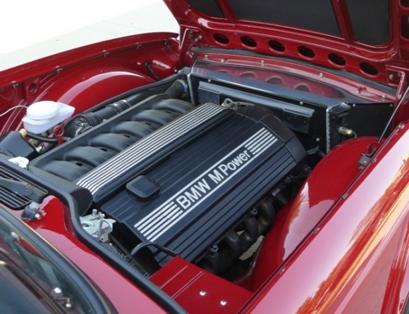

              Heres a picture with a S50 in a TR6:

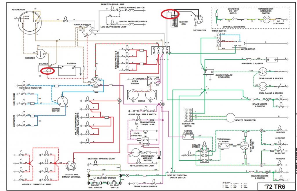

                        I've attached a picture of the Triumphs incredibly simple wiring diagram and I've circled the ignition wire along with the starter wire. Both have the voltage of the battery coming through when the switch is engaged and is connected to a ground. As far as I know, those are the only two components I'll be using from the stock TR6 wiring.
                        Edit: It may also be worth mentioning that in those two circuits there is no fuse (although I doubt there should be one, does an E30 have a fuse for the starter and ignition?)

                          the E30 does have fuses but they are not in the wiring harness, they are built into the fuse box. there's a fusible link from the battery to the DME that will protect it if there's an overcurrent or if somebody hooks the battery up backwards.
                          I don't think there is a fuse for the starter but there's definitely one on the ignition switch. I think it's 30 or 50 amps. There will also be fuses for the fuel pump and maybe a couple other things. the ETM is pretty detailed though and will show it all.
