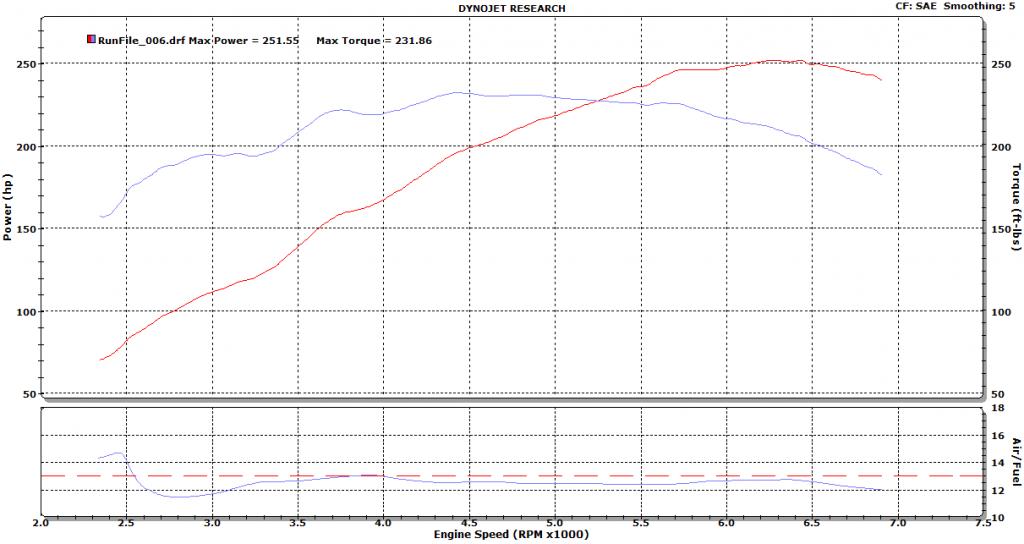

      Originally posted by npavlo
      328ijunkie,
      You should be able to calculate actual injector duty easily if you have your PW logged. It is simple math. If you are already at 85-90% duty, you will find you will eventually be tapped if you keep doing stuff to make more power. In your log, you can also see the injection time drop off on the top end since the VE of the engine is dropping off. That is helping the situation, and typical with M50 series engine.
      Can you explain what you mean by these engines not liking sub 12 mixtures? Typically on normally aspirated engines, that could be true, but not necessarily the case always. For example, a richer mixture can control knock at high RPM, which is an issue for these engines around 6000rpm.
      I am actually the one who tuned berlow94s Vipec, and while I am not looking at his calibration, I imagine the mixture target matches the ignition advance appropriated for making maximum power safely. He uses his car for road racing, and we actually looked at his detailed ECU logs (that the Vipec has on board) after his dyno sessions to totally validate mixture, knock, and more.
      Regarding the power levels he is at, upgrading to the larger injector allowed for much more accurate control of the fuel mixture, especially at high RPM.
      berlow94,
      There are lots of cars that can idle with 1000+cc injectors at 14.7:1 depending on the control system, the ECUs ability to compensate for flow, etc. I hope reading the above puts that into more perspective for you as well!
      I posted above the IDC (again sans dead time, which is much less than .8ms on factory injectors)
      As far as the mixtures go, of all the 24vs ive tuned they love 12-13AFRs at WOT, below 11.5 you get rich misfires/detonation so it hurts you not helps you.... S54s are different as are other BMW engines, i was speaking mainly about the M5X.
      Also if you look at my dyno thread 50+% of the cars i tune are track only as well. I make sure they are tuned to not explode :P.
      Originally posted by berlow94
      I'm making around 290 to the wheels on a dynojet.
      Would love to see that dyno sheet and full specs... 290whp is a crapton out of a 24v.

            Wait,
            You are saying that you that an M50 will rich misfire below 11.5?
            Never had that issue... Maybe that's a factory ECU thing.
            And you are saying that the engine detonates at rich mixtures?
            That's very uncommon too, since detonation is usually controlled by running a richer mixture as a general rule of thumb.
            You mention you tune for the track, but all your dyno thread shows is WOT performance tuning. It is all in STD correction too that exaggerates the numbers.
            Have you ever tried a good standalone system for these? Here is a plot of a STOCK S52 with a 3" exhaust using the same EMS system Andrew has. SAE correction too. These are done so everything is addressed. WOT, part throttle, deceleration, transients, proper lockouts, etc. Internal ECU logging, wideband closed loop, individual knock, CAN output, and tons of motorsport functions. That car was on 24# injectors, and maxed out essentially.
                  Wait,
                  Any engine can rich misfire/detonate, esp in NA form. You maybe are confusing detonation with pre-ignition. Detonation happens AFTER the spark plug fires....
                  And i dont have a ton of experience tuning M50s (maybe done 10) but other M/S5X familys are another story.
                  In regards to my thread showing only WOT Dyno plots, A i dont have an eddy brake dyno and B: how else do you show a non WOT dyno plot? Most of the tunes i do involve 1-1.5hrs on dyno and 2-3 on street to dial in PT.
                  Setting up a standalone on any engine is alot harder than you make it seem. Cold start enrichment, accel/decel transients, vanos, knock frequencies (which you can guess/learn from seeing it but is no where as finely tuned as a stock DME), etc.
                  Ive played with Haltec as well as Megasquirt. Only things i like over a stock ECU are wideband AFR targeting (which newer BMW ECUs do anyway), as you mentioned 'motorsports functions', as well as CAN output (on the nicer ones: Motec)
                  Either way, i understand your point of view but setting up a proper aftermarket standalone without a base tune that someone else has already spent tons of hours on, takes tons of hours....
                    Hey man, sorry took so long. I just saw this.
                    I think we are making similar points. Absolutely it takes a while to get the standalone ECUs setup right, but when it's right... its awesome.
                    For example, I guarantee you the knock control on a link/haltech/emtron/motec/etc is 10x better than the factory ECU. You don't have to guess on frequencies if you know some details about the engine, plus you can set up windowing, proper lockouts (including transients), adjust gain per cylinder, adjust threshold per cylinder, and count on each cylinder even individually. You can set the retard rate, advance rate, etc. It is pretty comprehensive, and a lot of factory ECU tuning can't even look at those settings. Kinda hard to adjust when the bore size of the engine changes, or the engines sleeved, etc.
                    You also don't need a Motec for a CAN output anymore! Andrews ECU (that's less than $2gs complete) outputs almost 40 channels over CAN to his motorsport dashboard which he can configure to display whatever he wants, plus alarm functions, etc. It really modernized the old stuff.
                    M5x I consider 2.5, 2.8, 3.0, 3.2 generation. Sorry I should have clarified.
                    Ultimately, it all depends what the customer wants and what their budget is. I'd keep an open mind about it regardless!
