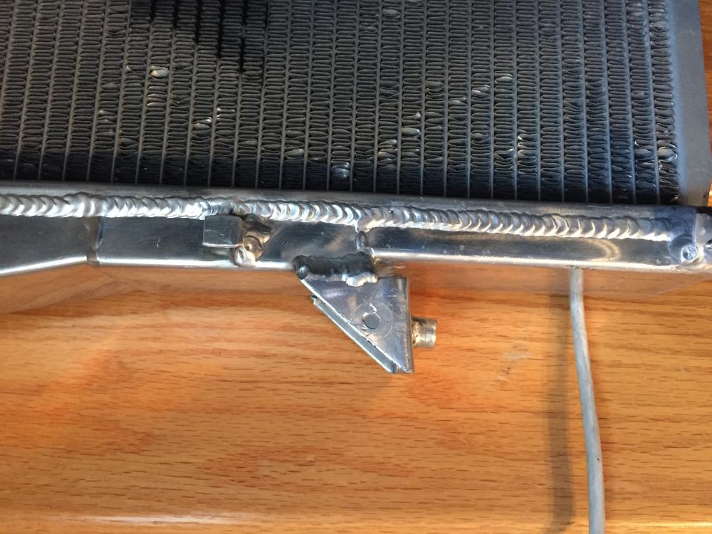

    Hi, I'm fitting an aluminum z3 rad into my E30 for my swap. Just wondering what people have done for mounting brackets? These rads use a different style mounting point on the sides. Anyone know if there are pre made metal brackets I can weld in or do they have to be custom made?
    Pic attached.
    Thanks.

    Assuming you have a late model E30 that should mount just like stock. Rubber bumpers and all.

      Yep, if it doesn't slot right in, you probably have an early model like me. I bought the brackets from BMW assuming the frame rails are all the same and the brackets would weld right on. That was not the case so I had to modify the brackets quite a bit. If I were you, I would just make the mounts from scratch.

        It's an M3 so it's the early model mounts on the bottom.
        I am probably just going to make the mounts and somehow use the factory black plastic mounts that are used with these.

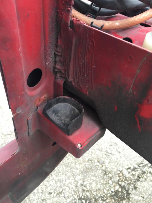

              Took this pic from a late E30 today. Does anyone know if you can still order this metal mount from bmw? It would be great if I could order two and weld them on.
              EDIT: Real oem shows two brackets I'm not sure if it's them though. #14 and #15 in the diagram.

                Yeah, I ordered those brackets. They didn't fit well so I ended up modifying them heavily.
                edit: They didn't fit at all. Like the frame rails had been changed from early to late cars.
