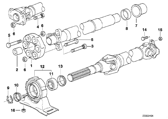

    yes i know i've asked before but i need a lil bit more deail. yes the getrag 240 from a 318iS will bolt-up to the m50 but what driveshaft+linkage is used? 325 linkage?? eurodepot says that the e36 driveshaft will work only when the e30 center bearing is used.
    heres a diagram of the e36 driveshaft.
    what number(s) are the center bearing?? and what numbers need to be switched over the the e30 center bearing??
    i just wanna figure this out as i am in the early stages of gathering parts for my swap.

    center bearing or also referred to as center support is part #12

      ahhh i see...thanks 1990m3...now some1 answer my Q about the shift linkage:)

        A local guy with a 240 on his M50 told me he shortened his driveshaft 2 inches, and all of his linkage is also shortened, I would assume 2 inches aswell. If you are already into your swap I understand, but from what it sounds like the 260 would be easier to use... since all you need is a 5spd 325/e/i driveshaft.
        1990m3 is right. The center bearing/center support bearing is 12, which would need to be substituted from an E30. Which makes sense because the E36 bearing is bigger and the driveshaft wouldn't be level if you used an E36 one.

            hmm yea that shorting driveshaft/linkage sounds like a true PITA.....meh i'll find a 260 kicking around np and it does make it easier to sell my m42 thanks for clearing that up
