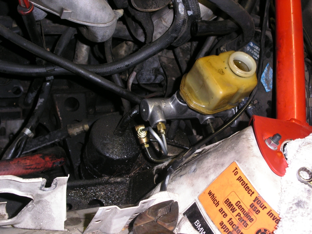

                details and pics of e32 booster and master cylinder please. Thought the common setup was e32 booster (same as IX), with the e34 M.C. and e32 remote reservoir. How does the e32 MC work in your 84, isn't it an ABS MC? How does it work with your non ABS chasis?
                • matt
                  • 3731
                  What's the difference between an ABS and non M/c? The one we pulled from the 7er looks exactly like the M5 version I bought brand new, and is the same piston size (25mm). As far as I know, the m/c you'd use is the same between ABS and non ABS e30s.
                  Edit: And using that ugly square remote res is dumb. Details of a GOOD way to do it will come when we get around to that part of the swap. All OE BMW parts, too.

                    I'd like to know the difference between the M5 and 7er 25mm booster as well. They have different part numbers, but they gotta be functionally equivalent. What are the sizes of the two ports where the brake hardlines hook up? Are they both 10mm?

                    • rs4pro3
                      • 5808
                      Non ABS MC's have 3 lines, ABS have 2. You can use a T for the 2 fronts to make an ABS MC work.
                      There are 2 different 7 series MC's the 750i is the 25mm one that works with the non IX style boosters. The 735i got a 25mm MC but it has the funky mounting that the IX booster uses.
                        Got a part number for the T fitting? 8-)
                        Edit: How about 34 32 6 755 557 and 34 34 1 111 435?

                          afaik all 25mm mc are the same... the only difference is that type of flange it has to mount to the booster... i believe all 25mm master cars have abs(this could be wrong) so you only need a T if yoru car doesnt

                            I used 34341111435
                            here is a shot of my setup
                            before
                            after
                            85 325e 2.7 ITB'd stroker
