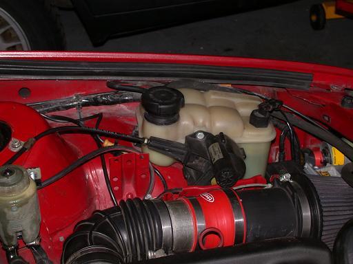

    Trying to get some ideas of a good place to mount the cruise module - anybody find a good place? Pics?

    I mounted mine on the coolant reservoir bottle - there's mounts on it for the three bolts.
      where did the stock 325i's have it?? id mount it there

        put mine above the ABS module on the drivers side.
          What bottle are you running? I don't see it on mine. Pic?

            i shoved it towards the fender as much as possible
              After looking at mine I see what you are talking about - this simple to some but even though maybe this should be in the stickied thread up top.

                Passenger side where the e30 M3 coolant resevoir is mounted.

                        Here's the pic although it sounds like you've figured it out
                          Thanks for posting the pic. This is how I'm going to mount mine. Did you bend the old airbox mounting bracket and strap the maf assembly to it? Can't quite tell from the picture. Also, any chance you know the part number for the K&N filter?
                          Has anyone added the mounting bracket/clip for the 325i coolant tank to 325e or m3?
                            How does the e30 cruise control unit hook up with the s50 throttle cable? Everything is there, just not hooked up to anything? Any help is appreciated.
