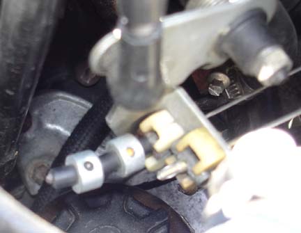

          How does the e30 cruise control unit hook up with the s50 throttle cable? Everything is there, just not hooked up to anything? Any help is appreciated.
          Thanks,
          Ryan
          I'd be curious to know myself.
          How did you guys go about hooking up the cruise cable to the S50 throttle body?
          • Jason89i
            • Sep 2004
            • 875
            vacuume hose, metal collars w/ alleen set screws. 20k miles, 5+ track days....never moved. see pic.
            [img/]http://www.r3vlimited.com/board/attachment.php?attachmentid=5644&stc=1&d=117396807 3
            cheers, jason
            • trent
              WTF? how come mine hooks up like stock??
              • rs4pro3
                • 5808
                cheers, jason
                ya that's about the same method I used when putting cruise on a buddies 87 with an s50. But used some vacuum hose adapters cut down in between the threaded adjuster.
                  Hmm. So on the track, you set cruise at around 120 mph on the straights, then press cancel so you can brake for the turn, then press resume after the apex? Sounds like a plan! (j/k)
                    i
                    did that on another one of my cars too. but the threaded adjuster stuck out too far and ran the potential of binding up on something at full throttle.
                    cheers, jason

                            Mine is mounted in the stock location. there is alot of slack in the cable so i think it doesnt work because of it. should i just cut it so its a snug fit to the throttle or does it need some slack? im not sure how the cruise modual works.
                            • WillisE30
                              • Jan 2007
                              • 831
                              I was running into a similar problem with mine. I routed the cable differently. I don't have the car here with me but I either ran it behind the booster and looped it back down to the throttle body or I routed it just behind the resevoir. Either way it took up all the slack and my cruise works great.

                                i cant see how running it in a different way will take up the slack. its like a bike brake line. i guess ill just try putting an RC collet on it and seeing it it works
