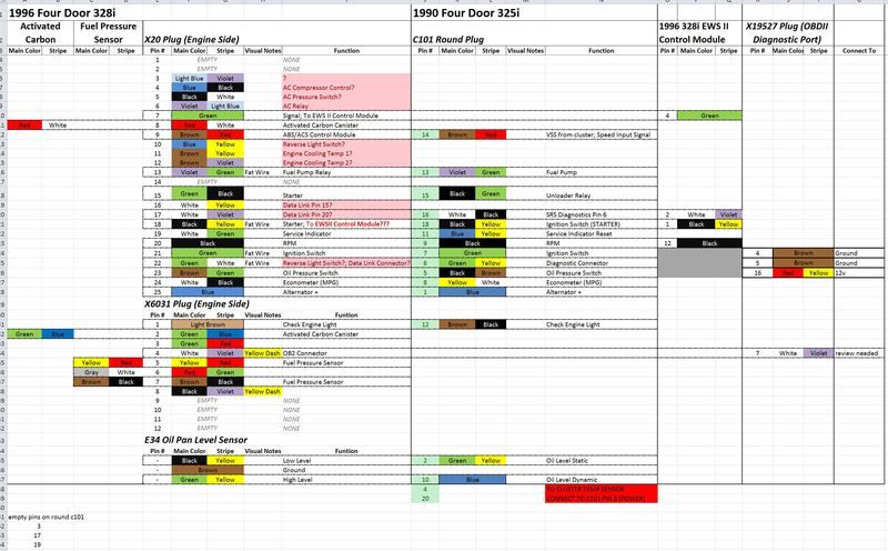

Looking for m50/2 pinout from 86 325es body

    need , i have a 525 ecu but idk if that is necessary for what i need.

      wedophones.com (i think thats the page) every swap is slightly different, but its only about 7 wires to figure out. this is part of the fun of the swap. the research

          Does your car have the round c101 or the square?
          this thread is gold
          this is also helpful

            Originally posted by 2mAn
            Round c101 in my e30 ! Thanks for the links :)

              I'll share mine(M52 OBII with EWSII) for viewing purposes only. I will not take any responsibility of anyone's actions from following these wiring pins. I have done the research, but I still need to go over the connections for confirmation.
              I will also be repining these onto a new c101 plug.

                I was actually going to repin on a new c101 too, thanks!!
