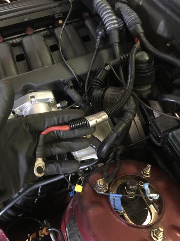

    S50 No power to Fuse box! SOS
    So, I think I have most everything in it's rightful place. There is still one wire that has me stumped and I think it is the power to the fuse box. (you can see where it tried to weld itself to my strut tower)
    That said, where exactly does this wire go!? its the last thing stopping me from starting her up!:p

    Remove that wire. Hook up the factory wire from the fusebox to the b+ connector in the enginve bay.
      This. That wire splits into two inside the harness box thing. I removed it and used the e30 starter/fusebox wiring. Much easier/cleaner.
