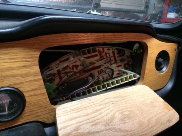

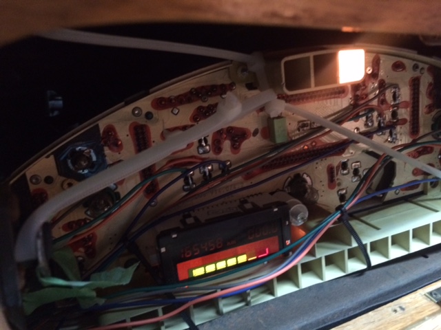

          Hey Sea Aych! If you remember me at all, or if you noticed in the video, I'm the guy with the Triumph TR6. Unfortunately I'm not sure if the stop test is working for me, as I only have certain things working with the gauge cluster (mainly speedo, temp sensor, and tach). See picture for my janky setup hidden behind the glove box.
