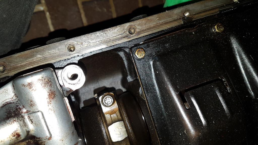

                    • ba114
                      • Sep 2015
                      • 364
                      Originally posted by ForcedFirebird
                      http://www.realoem.com/bmw/enUS/partxref?q=11411740154
                      This shows all the e36 oil pump housing were the same?
                      Maybe for US cars. I tried to bolt my m52 oil pump into my M50 and only 2 bolts would go in, not the rear most. I have both blocks standing next to each other at the moment and it's visibly different mountings.
                      My m52 is an aluminium (euro) block however so perhaps they were cast different.

                      • pazi88
                        • Sep 2015
                        • 584
                        You have non-vanos engine? Even the euro m52 alu block has same oil pump as m50 with vanos. Only different one is m50 without vanos. It has the smaller gears and the oil pump housing is bit different:
                        (left m52, others m50 non-vanos). That one bolt ole is located bit differently but as you can see it can be drilled out to match the older pump.
                        • ba114
                          • Sep 2015
                          • 364
                          Isn't that what I said??
                          I have 2x m50tu blocks and 1x m52 blocks. The m52 pump does not bolt up to the m50tu blocks as the rear most mpunting hole is not the same.

                          • pazi88
                            • Sep 2015
                            • 584
                            No: I meant that the m52 oil pump should mount to m50tu (m50 with vanos) directly. That's according to my testing and according to the part numbers. m50 without vanos is different thing.
                            EDIT all thought there may be some overlap in parts between the engine generations as there is in many cases with bmw. For example most of the m52 engines uses oil filter housing with plastic cap but the earliest ones use the same oil filter housing with metal cap (and power steering pump etc.) as m50 engines.
                            • ba114
                              • Sep 2015
                              • 364
                              Right. Well per pic above, oil pump from aluminium block m52 from '96 328i fits all but one of the mounting holes on m50tu as stated previously.
                              You mentioned it would fit if you enlarge the hole in the pumps mounting.
                              I think we're saying the same thing.
