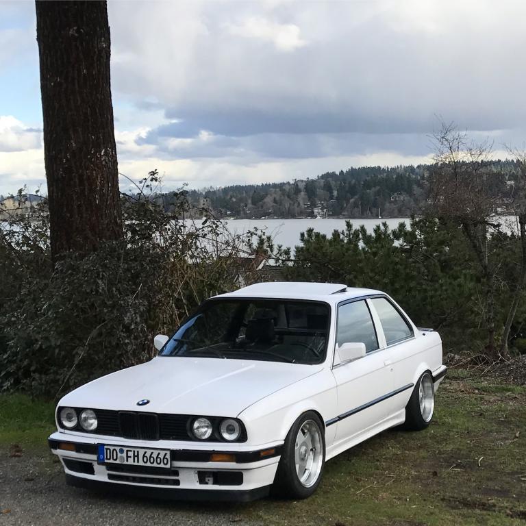

    Hello I just purchased a M50b25tu (with Vanos) swapped e30. Engine has 120,000 miles and has been recently overheating. Usually overheats when car is idling for more than 4 or 5 minutes. I currently have a small pin hole leak in my radiator and oil is leaking into the 6th cylinder. I just purchased a new radiator and valve cover gasket/spark plug. Hopefully those parts will fix this problem if not does any one have suggestions as to why the engine is overheating?
    Thanks,
    Mckay
