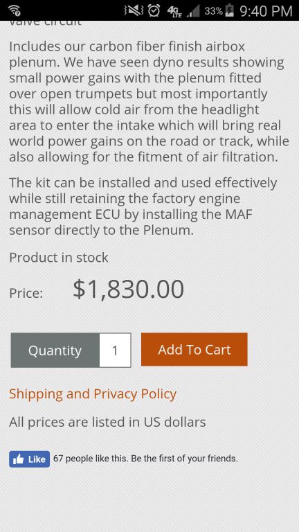

    Hey I just picked up an itb setup for an s50 from RHD. On his website it says yiu can run the stock ecu and whatever tune you currently have if yiu attach the MAF to the Plenum that comes with the kit. Does anyone have any info about anyone doing this or read a build somewhere or atleast seen a pic of this setup with a maf. Thanks

    Screenshot from the website

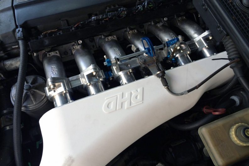

          so you managed to fit the RHD ITB kit in the e30 chassis? Any modification necessary? I was looking into this, but the guys at RHD told me it wouldn't fit.
            That picture looks like an E36 engine bay to me.
                That's what I was thinking as I thought I remembered seeing a picture just like that describing the 3d printed prototype plenum.

                      That's definitely not an e30 bay, look at the cowl and heater core inlet position. That being said, also curious. I've been tempted by these for my car

                        any update on whether or not this will fit in the e30 engine bay?

                            it wont quite fit. Needs modification to clear the booster. Someone i know just fitted one with a clio booster and still needed to modify the plenum
                              Ive heard some people say the hood wont clear the throttle linkage but I have heard other people say it clears just fine. not sure about the booster though
