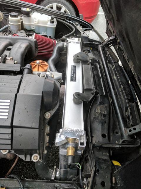

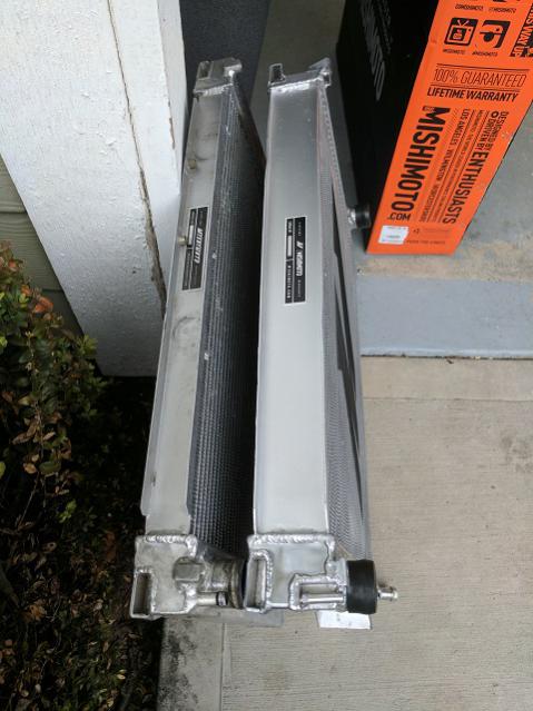

              Yup it fits, fairly well too.
              Thicker rad means the lower hose which already fit tight in there now fits even worse, even after trimming.

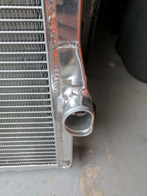

              Mine arrived well packaged and the box in good condition but it still had a slightly crushed outlet port. I'm debating cutting the original port off, bead rolling a new end and welding a 90 degree fitting on instead as it would probably give better fitment for the hose though it'd be a coont to install.
              Also of note, the Mishimoto Z3M rad has a better drain setup in my opinion (angled spout) but the overflow barb barely accepts a hose/clamp with the way it's designed and fabricated. Cooling is great, clearance to the front of the motor is acceptable. Top mount fits a bit worse than with the e36 Mishi rad I had before, so that will need a bit of love too.

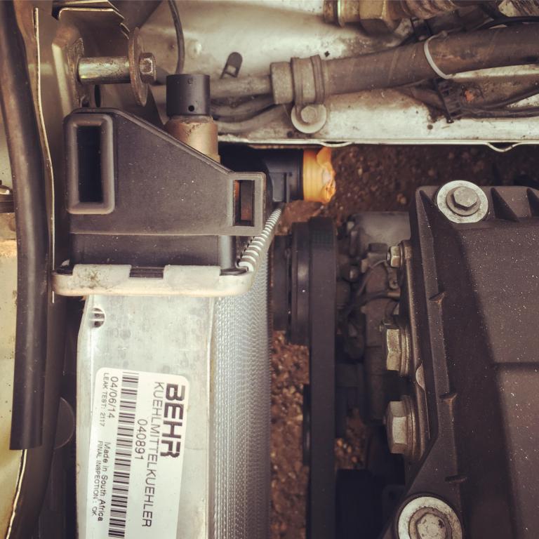

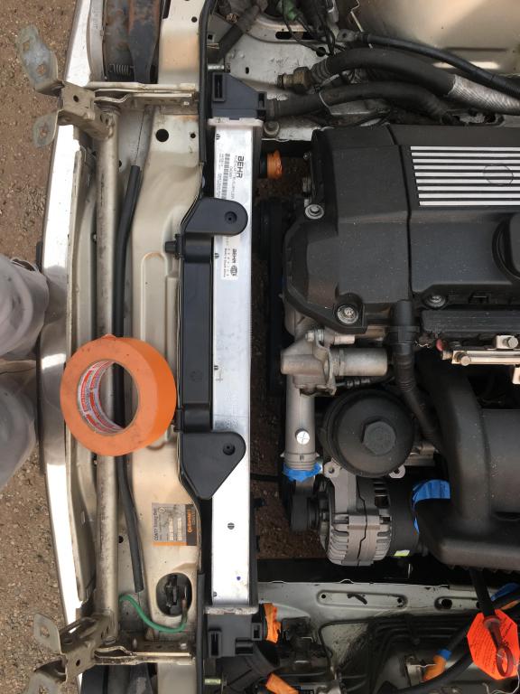

                    Stay away from Mishimoto. I had (3) that cracked and leaked. I have a z3m Behr radiator now with a Spal pusher and have had no cooling issues. Fits perfect.
