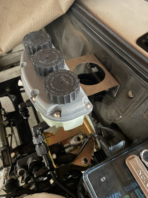

    To fill the void of the large booster, I decided to run the Massive Lee dual master booster-delete setup with remove reservoirs. A Tilton 72-250 balance bar was used with (2) Tilton 76-750 master cylinders, and a 3-chamber Tilton reservoir. The lines were all custom -4AN lines to the new masters as well as the clutch master. Unfortunately, during the process of power bleeding, the Tilton 3-chamber reservoir leaked like crazy and I was informed by Tilton that this setup could only be manually bled. Well, that wasn’t the answer I wanted, so I ended up purchasing 3 individual reservoirs from Tilton and fabricated a custom bracket. This was a much better solution and in hindsight I should have gone this route from the start.

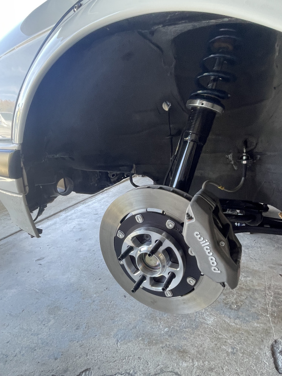

    The decision was made to go to Massive Lee for larger brakes and purchase his 300x32 kit for the front and rear of the car. The plan at the time was to run a 15” wheel setup to keep rotational mass down. The kit was very high quality and the parts used were all Wilwood components.
    ​Click image for larger version  Name:	IMG_1510.jpg Views:	3 Size:	184.5 KB ID:	10105009
    Click image for larger version  Name:	IMG_2321.jpg Views:	3 Size:	268.5 KB ID:	10105010

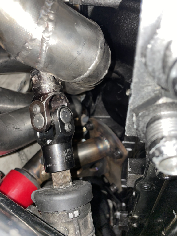

    -Condor Airbag Steering Shaft

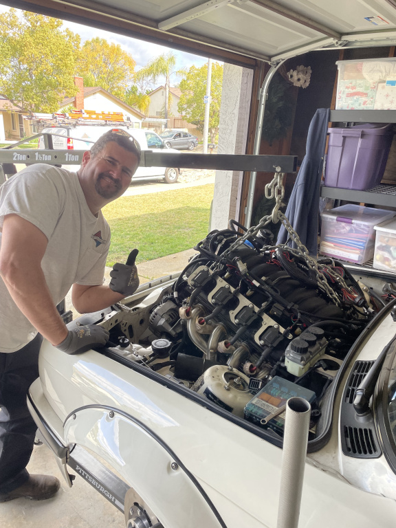

    The hoist was acquired from another friend, and we were ready to mount this beast in its place. The following weekend we had the engine and transmission in its new home with lots of prying, cursing, bleeding, etc. The LS was a tight fit in the e30 and lots of hammering was required. The transmission opening on the top of the tunnel also needed to be clearanced for the Tick Performance shifter. Nothing a grinder couldn’t handle. Sikky has a great video in their e30 LS 2 swap project series demonstrating the portions of the bay and tunnel that need to be hammered and shaved. Check out BMW E30 LS2 Build Pt 4 video. The engine/transmission installation took us around 5-6 hours.
    Click image for larger version  Name:	IMG_1309.jpg Views:	0 Size:	238.9 KB ID:	10105018
    Click image for larger version  Name:	IMG_1310.jpg Views:	0 Size:	235.0 KB ID:	10105019
    Once the LS and T56 were in place, it was time to start assembling all the other pieces around the engine. The first on the list was the Condor steering shaft. Once we were under the car and started assembling, we knew we had a problem. The Sikky headers were rubbing the steering shaft. So down the rabbit hole we traveled. We ended up removing the driver side header, pie cutting the tube in question, and machining down the steering shaft. So far this solution seems to have worked. This was likely caused by not utilizing the Sikky engine/transmission mounts, but I’m not too sure at this point.

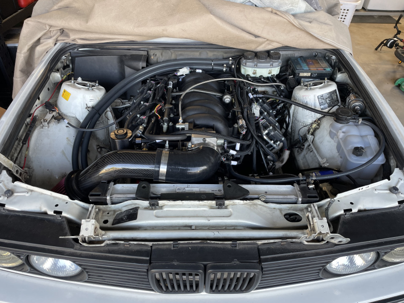

      After we felt comfortable with the install, we filled fluids (engine oil, transmission oil, water/coolant, fuel, etc.). The start tune was double checked and we had power to all components. Well here goes nothing…key in ignition, switch to start position, and cross our fingers. SHE FIRED RIGHT UP!! Idled like a champ! Ran super rich with the learn turned off, but it ran!
      Click image for larger version  Name:	IMG_1502.jpg Views:	0 Size:	263.5 KB ID:	10105024
      The first time I was able to “drive” the car was to load it on the trailer to take to the exhaust shop. The O2 sensor was unplugged with learn off, so ran rich again, but was able to drive it on/off the trailer.

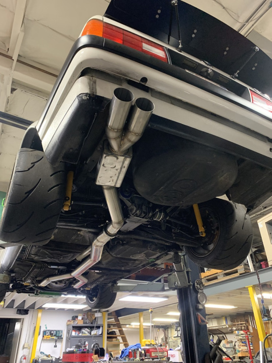

            The exhaust is finished and oxygen sensor is installed. The skid plate is also reinstalled and has plenty of room under the car.

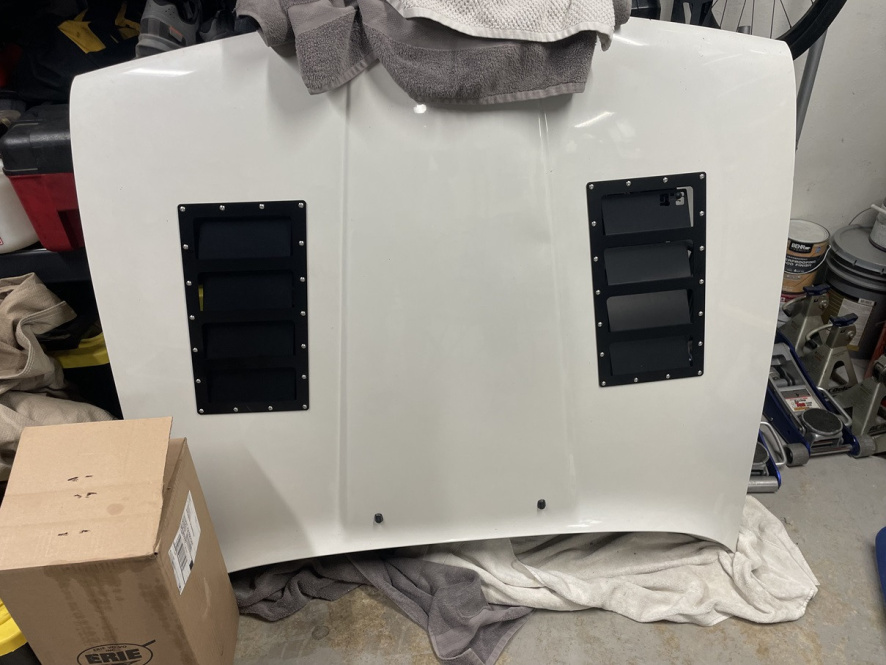

            The hood vents are installed. I need to see how the hood will clear the front throttle body to see if more openings are required.
Name:	Hood Vents.jpg

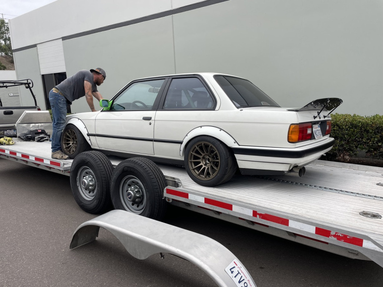

            This is how the car currently sits (on a trailer)...
Name:	Car on Trailer.jpg

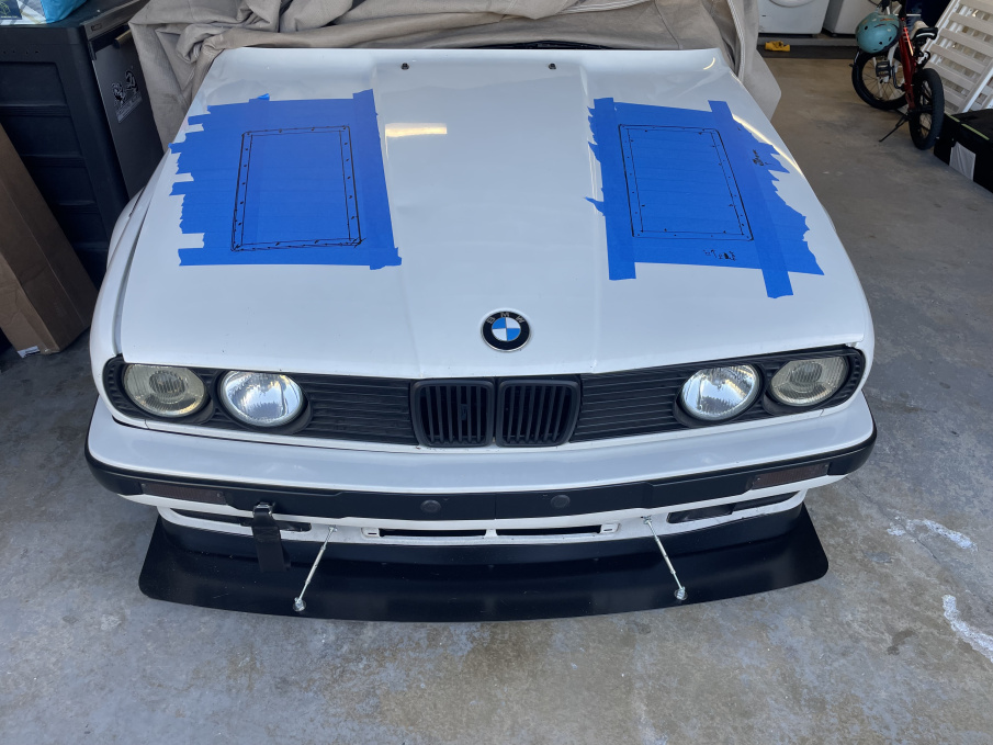

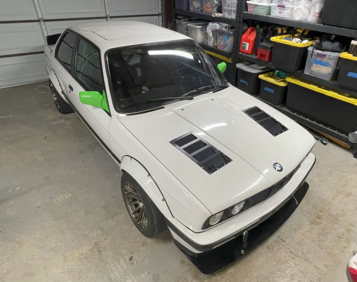

                    Well the vent and return fuel lines were 100% connected to the wrong hard lines which explains the high pressure. Had to pull out the fluid reservoirs, the master cylinders, and the top strut bar to be able to reach the lines. Finished late Sunday so wasn't able to start the car to 100% confirm, but primed the fuel pump and pressure was lower which is a good start. Looking from the top of the engine bay, the top line is return, the middle is supply, and the bottom line which is also the smallest is vent to the tank.
                    I was able to make some relief cuts in the hood this weekend as well to fit the intake piping and the brake reservoirs. Honestly, the hood fit and looked better than I expected. I thought I would need to cut holes through the entire hood which thankfully didn't need to happen.

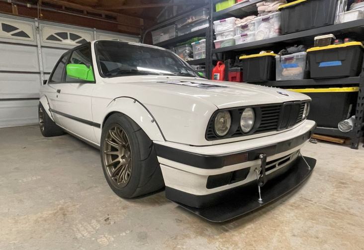

                    Here's the current state of the e30...

                          You will definitely need a solid steering shaft. Mine barely clears the headers and required some slight machining/header modification.
