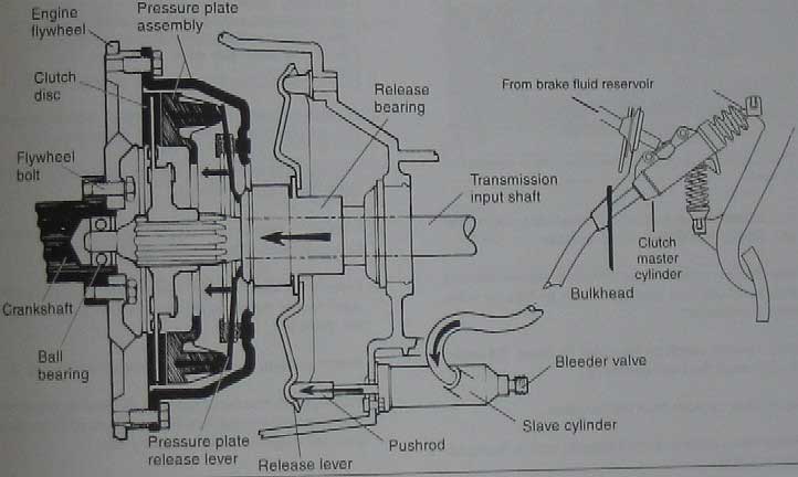

                      I've attached a picture of the clutch system. You'll notice the lack of any brake boosters and brake MCs in the clutch hydraulic circuit.

                        fair enough, my apologies. I didn't realize there was a master cylinder at the base of the pedal, I thought it was only visualizing the slave cylinder.
