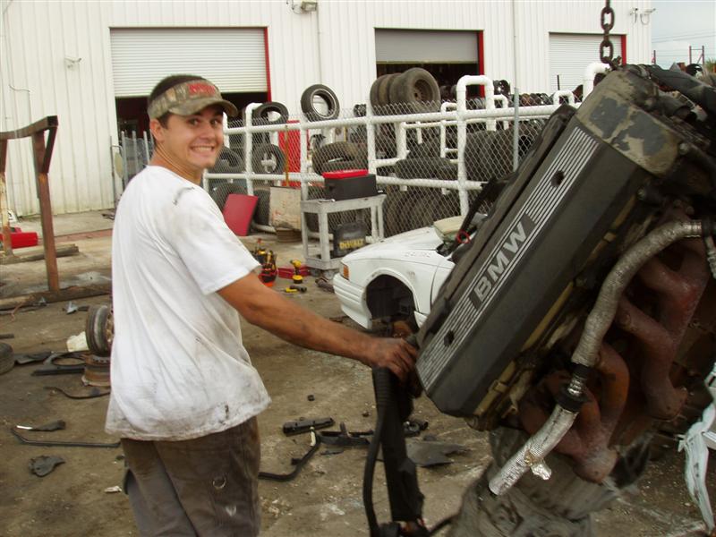

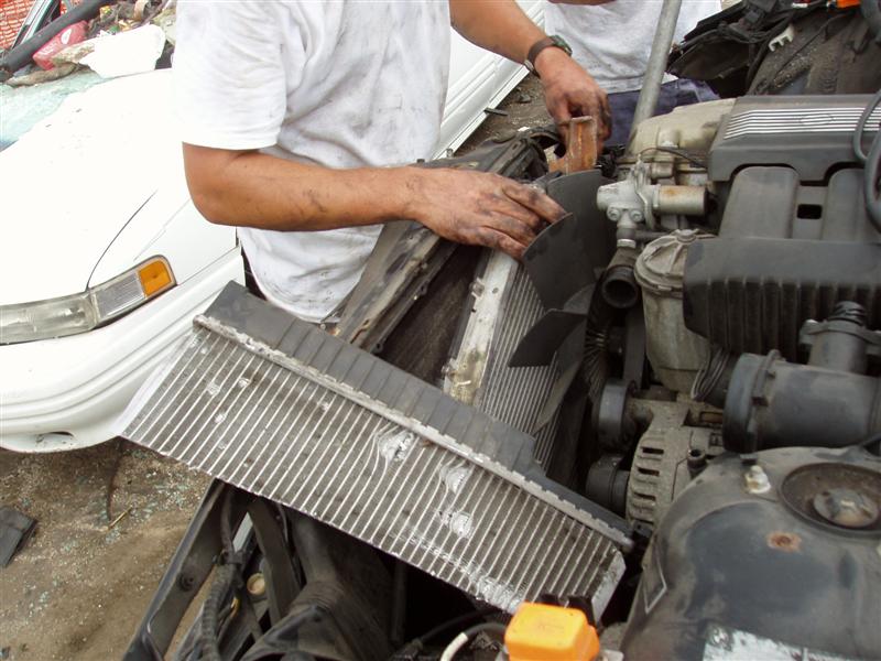

                    so what exactly do i need, we pulled the motor out (what a bitch) and i was wondering is i need everything.... AC Compressor, Alternator, Starter, Manifold, ect...... now i grabbed the DME and there was another computer box on the top of it, do i need that too? i have the whole engione harness. im going back tomorrow to finish and take what i need and the guy is probably going to charge me for every nook and cranny, so if i dont need stuff it will save me money
                    thanks

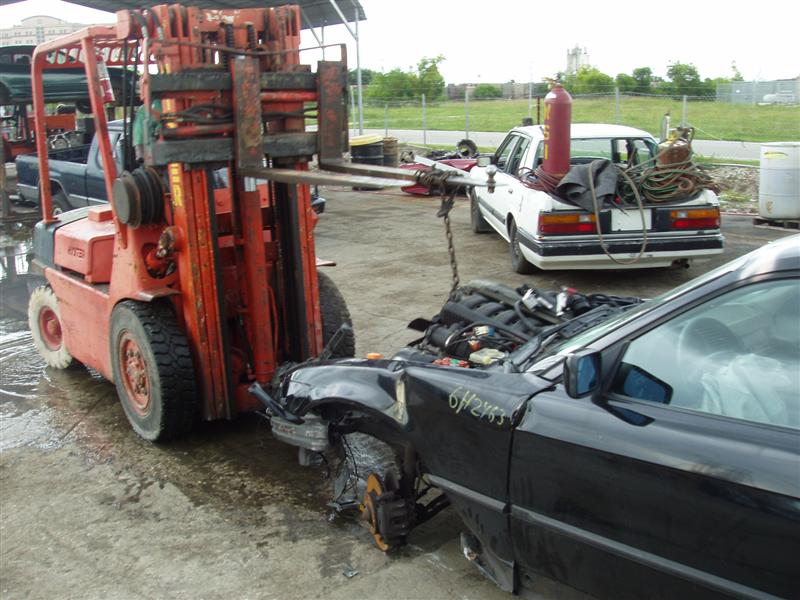

                        Electric saw, Forklift and pipe bender FTW! :D

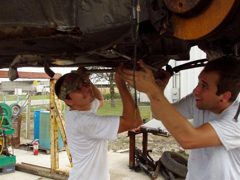

                          hells yeah. it took us 3 2 1/2 hours. the frame was totally wrapped around the compressor (not hitting the engine though)
                          then we had to cover it for the night... :D
