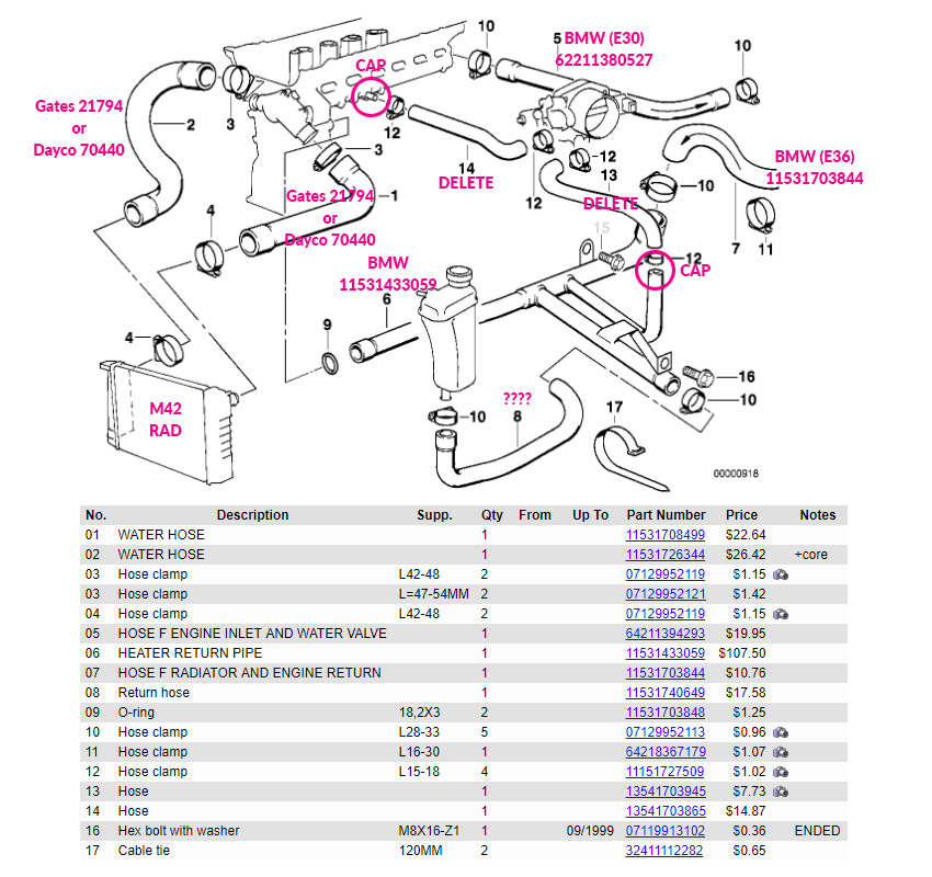

                  Sweet I feel like I'm getting close. Threw this together to get everything straight... still not quite understanding what to use for #6 and #8...
                  Mind telling me if I'm right so far? Bear with me as I haven't pulled the intake manifold yet to clean everything up... I'm trying to order parts in advance if possible before diving in (I have quite a list of things to clean up while I'm in there).
                  Assuming this is right so far, here are my questions/assumptions...
                  - I also need #6 metal pipe
                  - I need to cap the nipple between #14 and head (which is currently routed to my expansion tank)
                  - I'd also need to cap #6 where it usually connects to TB hose #13
                  - Not sure what to use for #8. Obviously this is specific to M42 rads since placement is not as shown in the diagram
                  Thanks again for helping me sort this out.
                  M119 M42 M62 S52 S62

                      If you have the metal line (mine was from a 99 m coupe) 6 hooks direct into the back of the water pump. There is no hose.
                      From your prior post I thought you had 8 sorted running direct from your expansion tank. 8 connects to 10, 12 is crimped and welded. That’s how I have mine. I used an expansion hose from a 325e that I had laying around. Cut one end off to make it a smaller fit on the metal line. It is tight but it works. I am sorry don’t have the p/n for that one.
                      Shoot me a pm if it’s easier to talk. Happy to send my phone # to talk through.

                          Thanks brads2002. I updated the diagram, how are we looking now? Only part # we're missing is the 325e hose you used. I'm sure I'll be able to figure something out with leftover parts and will try to update this when done for others to use.
                          Dagamus(NM) - If you want to keep the TB heater you can keep #13 and 14 AFAIK.
                          • Dagamus(NM)
                            • 621
                            I get that, or you could just run a length of hose from pipe to port.
                            But what benefit does deleting it offer?
                            Seems like pulling the s52 metal pipe out to crimp and weld it along with placing a cap over the port on the head would be more work/hassle than just leaving the hoses to the throttle body. I get that heating a throttle body is dumb and unnecessary in almost all usage scenarios.

                              My engine came deleted and capped. I don’t think it’s necessary though. Just cleanes it up a bit.
                              Great work on that diagram. That will be a big help for future installs. My stock m42 reservoir hose looked like it would have fit too but the bends didn’t work as well as the 325e hose.
                              If I can find a pn on the hose I used I will report back.
