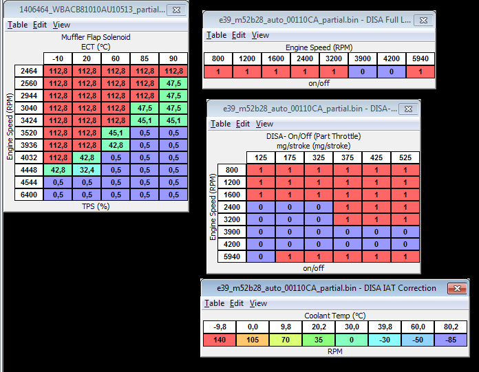

        Originally posted by Daeldalus
        Aren't the muffler flap and the DISA in a pretty similar map already? The DISA turns off at 3750 rpm and if I remember correctly the muffler flap opens at ~4000 rpm.
        Also how were you planning to do the idle control valve? To use the m50 or m52 one you would have to find a proper hole for it. My thought on it was to use the stock m54 one by using a dremel tool to open a channel between the m54 ICV holes and the main intake runners.
        Well you tell:
        Left is muffler flap map and three on the right are disa maps from m52tub28.
        The m52 and m54 ICV is same. M50 also uses pretty much same valve. That is not a problem. Yeah I have drilled holes from the idle runners to main runners close to head. Should be fine.

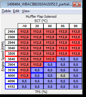

        How I would edit the muffler flap map.

          On the muffler flap map. Red means 12v blue means 0v? What does green mean on the original map?
          • pazi88
            • Sep 2015
            • 584
            Yeah pretty much. It's pwm output and those values are roughly pwm percentages.

                  Could also change the logic on the muffler flap map to use load as the x axis instead of ECT.
                  Or you could use the EVAP purge valve map to control DISA
                      What does the purge valve map look like?
                      Completely different. But it has load axis, instead of temp so after editing it to match disa map on ms42/3 it would probaply be better.
