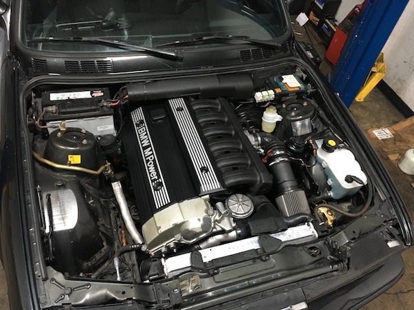

            I would get the E36 power steering reservoir bracket, so you can mount it down on the engine arm, like BMW designed it to be. However, if you don't like that, you could use the E30 power steering bracket and E30 hoses and put it up top somewhere.
            Here is a conversion I did a few years back for "cbouchez". He wanted the reservoir on top, with a modified E30 power steering reservoir bracket. Really all depends on personal preference.
