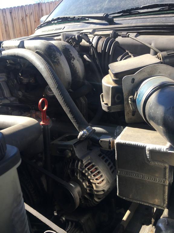

            I built this baffled one for my m42, also have one on a s50 n/a and on my turbo s50 it has a baffled and scavenge back to the downpipe
            HyperWerkz
            89 mtech2, s50, AR Kit, borgwarner s362, e-85, 15psi... 592whp
            " enjoy the show "
