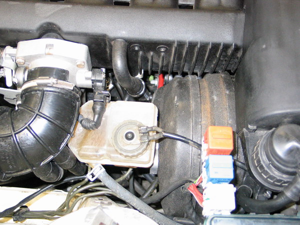

Here's my tight-fit. 325ix booster bolted directly to the firewall. Had to enlarge the mounting holes to get it in. Very slight interfearance with the intake manifold fins. Certainly non ideal mounting as the ix only has two studs. I havn't tried shiming the motor to gain more clearance. I believe I have the M5-drivers and 535-passenger motor mount setup. Despite the negatives, it fits...
