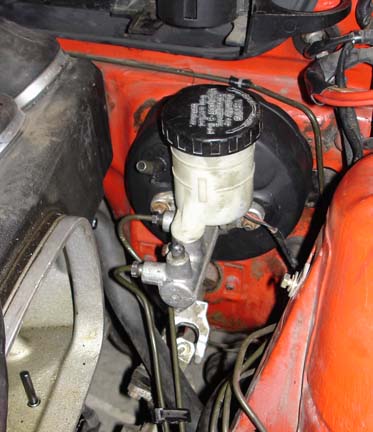

                      here is the pic of my booster. note....new brake lines bent to abs unit. brake line on fire wall slightly moved. other modifications included extending the threaded rod 1/4". (thread pitch was different between e30 and geo). and drilling new mounting holes in firewall.

                                What booster/MC does this look like?? I wonder if the intake was cut out?
                                From Azevedo Motorsports website...
