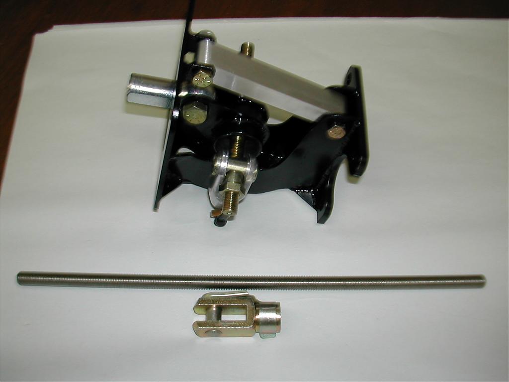

        I have received the prototype dual master bracket from my fabricator.
        Very nice work! I should have it test fitted by the weekend.

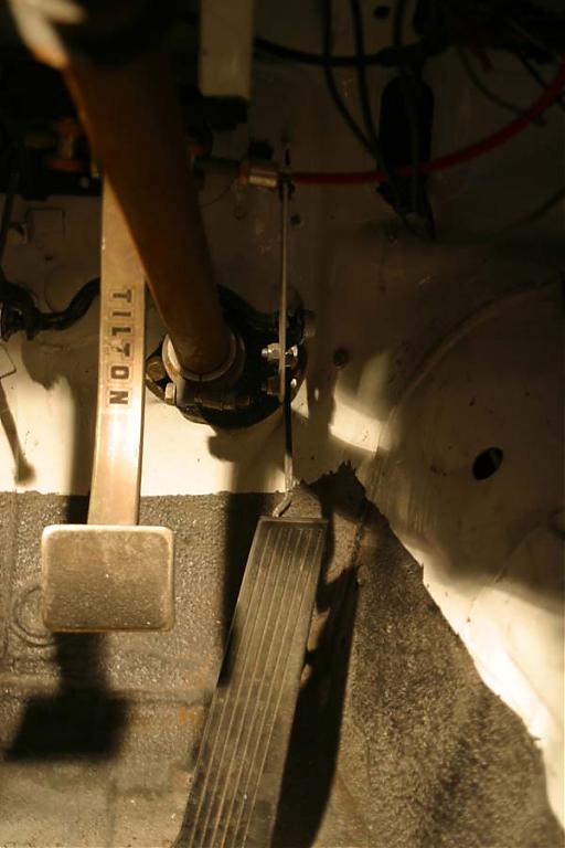

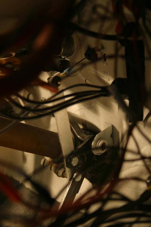

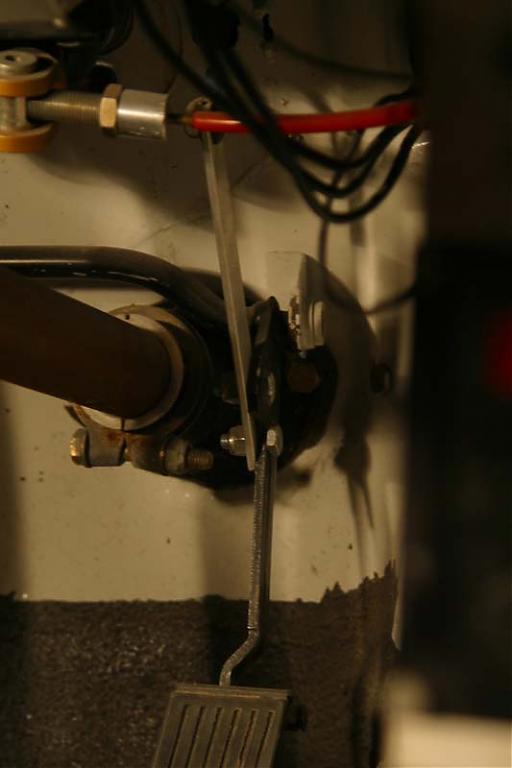

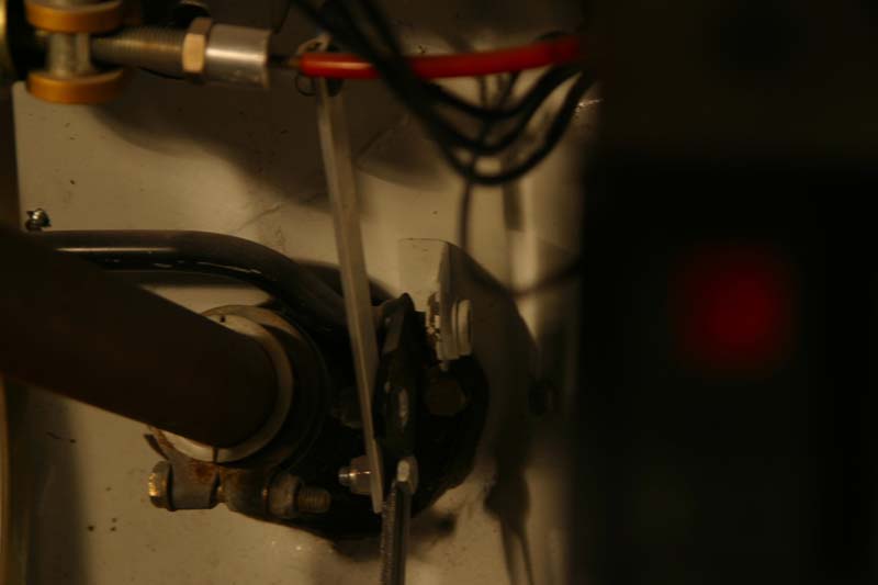

                  #98
                  Pics for Mike. Sorry these aren't the best...my camera doesn't like dark subjects. Plus it isn't the easiest thing to get a good pic of. Hope you can understand what I did.
