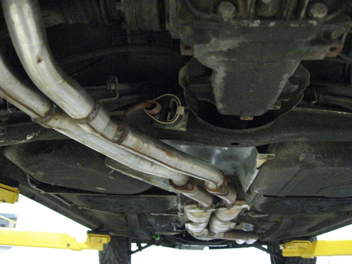

                    My SI isn't resetting either. Just turned from yellow to red and it's making me red looking at it all the time.
                    My exhaust is poop.
                    But the s50 is more fun than any NA m20 could ever be.
                    • EtaSport
                      • 2853
                      that looks better than my exhaust.
                      My econo gauge works but its not accurate. You missed wires in your c101, especially if your SI reset doesnt work. Everything in my car works with the exception of the oil level. I have the sensor, but haven't wired it in yet.
