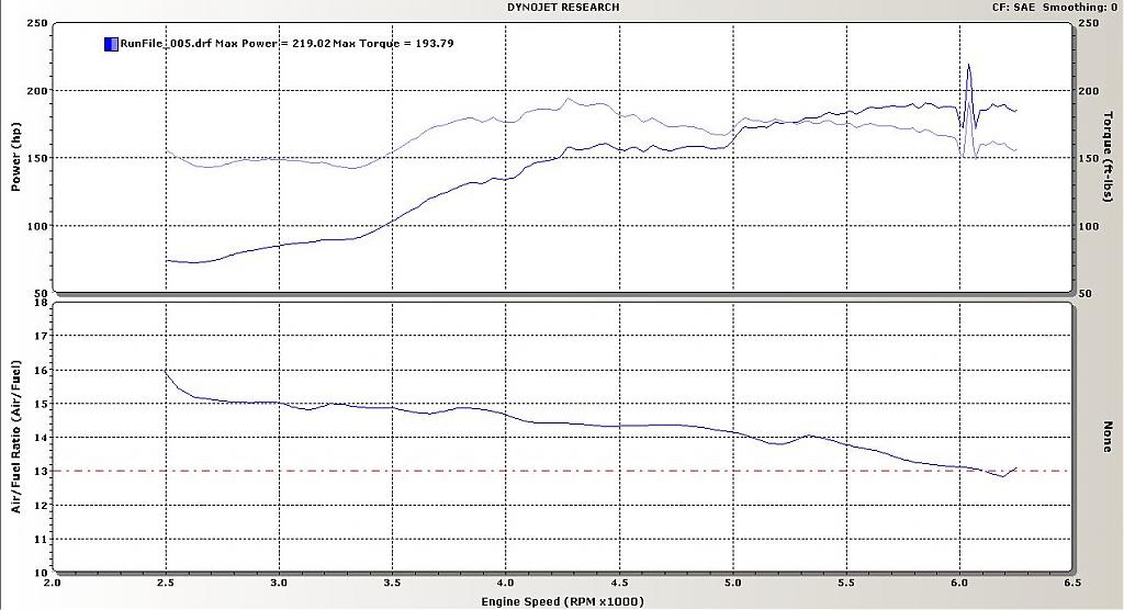

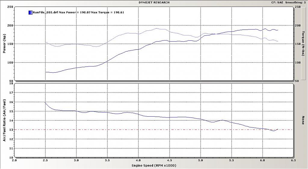

          Dyno results: ugly
          You'll notice the huge spike in the one picture with no smoothing.
          Thoughts?
          E30 Wiki: e30dohc.com/wiki
            That was less than impressive.. Around 20% drivetrain loss with 240 bhp... and you dealing with a dynojet that gives the highest numbers of any dyno. E30Josh put down 250 whp (on a dyno dynamics which is 15% less than a dynojet) on 12psi with a low compression m20... with just MS for fuel only...

                Your A/F ratio looks lean - you don't make it to 13 until close to red line. It might be a good idea to stay off WOT until you get that chip.

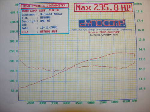

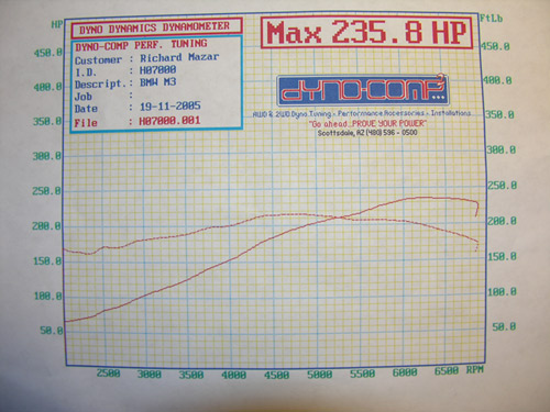

                            Here's my dyno graph, BTW.
                            Mods on my '95 e36 M3: Intake, 24#inj., URI crank pulley, 3.5'' HFM, Stickley chip. Note I still had stock exhaust.
                            Second graph shows A/F ratio and HP.
