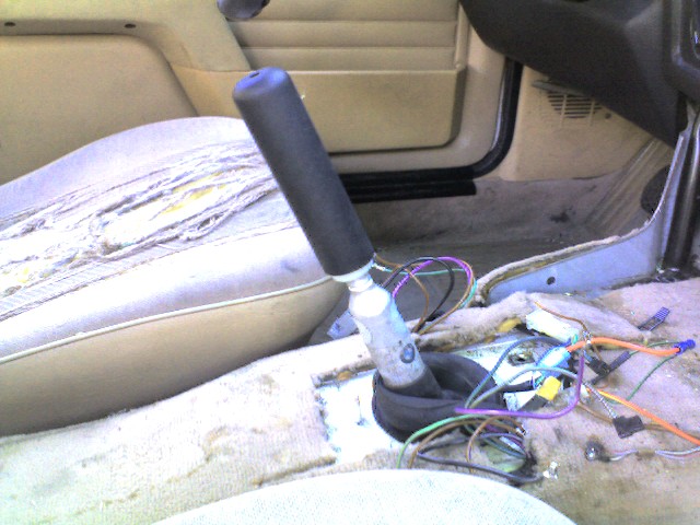

    I took mine out to put in the manual shifter and cross the right wires so the car will crank without the neutral switch... never bothered putting it back. Cleaner look.
    Anyway, do you have any exhaust leaks?

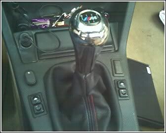

          ??? Cleaner look for a racecar. I like my console with the window switches and storage tray and all, it's useful stuff in a daily driver.

              can we get some pics matt?

                    Here's my setup after the manual swap. Sorry no pics of wiring, but I pretty much just ran the greens ti switched and grounded it so the little blue light would work.
