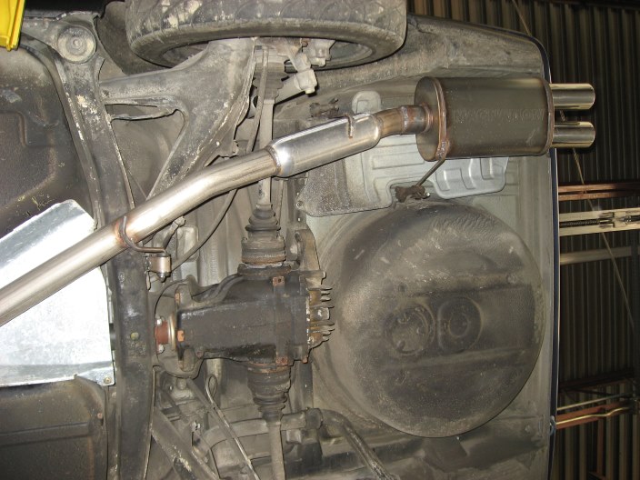

    s50 with Ebay SS headers into single 2.5" w/ flex pipe, then Magnaflow converter w/v-bands, then . . .
    small straight through resonator into Magnaflow single in, dual out exhaust?
      pretty much what imma be running. should be pretty loud, but not annoyingly loud.

        Shouldn't be too bad.
        I like that setup... What's the part number for the muffler? Can we get a shot of the valence and tips?
          Shouldn't be loud. My full 3in with a borla xr-1 is loud...

            Im running something very similar with my v8 and it sould be fine. As long as you dont go ANY bigger than 2.5!

              where did you find the 2.5 magnaflow muffler? I can only find 2.25!

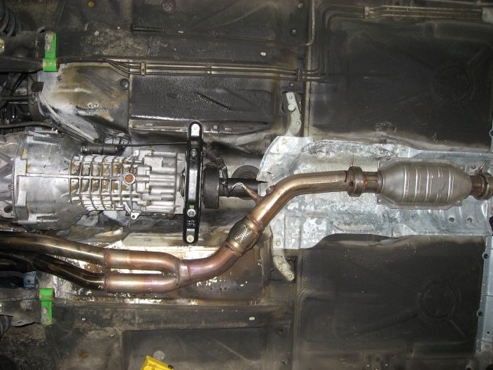

                  That looks super Doug. I like the look of the merge pipe and the flex fitting. Is that OBD1 merge or did you make it? Info on the "did you make it?..yes I did" answer if you did.
                  Looks simple and efficient. Must copy.
                    If you cut off the 2.25'' inlet at the weld, you'll have a 2.5'' inlet.

                      One question i have for you: what is the use for the flexpipe? is it to insulate engine vibrations that go through the manifolds from going further back? I get a lot of unneeded vibrations and nasty sounds, and i have suspicion that they are exhaust related. (perhaps downpipes rattle somehow, as the noise comes from the front pass side of things, can be heard loud and clear when in 4th or 5th at around 2-2.5krpm and giving about 70-100% throttle)

                          i did, then i took them off, then i change mounts for stock e36 ones. Just a mild reduction in noise.
                          I have a feeling it's exhaust leak somewhere in the manifolds' general vicinity. When i drive the car i can smell the stinky exhaust (but i don't run cats right now, so..)
                          Soon i'll be changing for obd2 manifolds, will change studs, gaskets... hopefully i'll find a leak that will fix the noise issue
