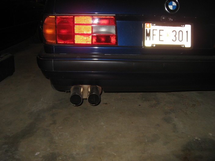

    Here is a picture of the rear valance and the tips. Sadly, they look really nice - they don't stick out too far and are well centered.
    The car goes back to the exhaust shop on Wednesday morning for a different muffler. If that doesn't help enough, I may ask for a chambered resonator in place of the catalytic converter. I hate to be a polluter but I hate more to have this fun car that I can't stand to drive.
