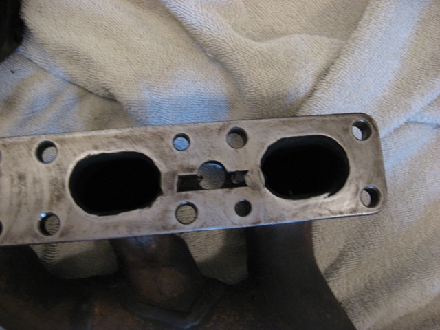

    There are many ways to go about doing this. If you choose to get the air pump gaskets and pattern a blockoff plate from them, you must use the OBD-II gaskets.
    The OBD-II gaskets don't have any extra holes in them. However, they are 3 ports wide (so you need 2 gaskets for an engine), unlike the OBD-I gaskets, which are 2 ports wide (so you need 3).
    If you weld the ports shut, you just need to put a big blob of weld metal at the edges of the injection channels. However, this method requires a pretty good welder because the flange is very thick and you must get good fusion with the weld.
    After welding you can use a belt sander to bring the level of the weld back down.
    Here's a pic of someone else's manifold:

        I'm not absolutely sure the dimensions are exactly the same, but a lot of E36 people have bolted up OBD-II midsections to OBD-I cars with no problems. This isn't the same thing, of course, but at the very least they're going to be close if not exact.

            I'd just go with the OBD-II gaskets. There are no extra holes or cutouts in them. As long as the welds are good and flat with respect to the rest of the sealing surface, there shouldn't be any problems with leaks.

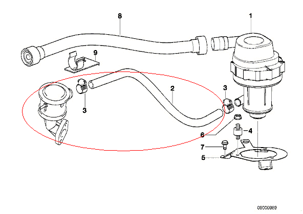

              I left all the air pump connectors on my exhaust manifold up to the rubber hose that connects to the airpump.
              Edit: see attached picture. I have the parts within the red circle still attached to the manifold.
              Should I close this off? Does it affect anything?
